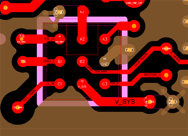

This is how the IC is connected on the board:
I have tested the output pins, they are not shorted to eachother, ground, V_SYS or anything else I thought of.

    If you see an OC Detect error even with not motor connected, then it kind of eliminates the motor being the issue. It points to either a short in the layout from manufacturing or possibly from soldering the part onto the board (BGA packages are tough). From what you wrote, it sounds like you turn on the part and it acknowledges I2C transactions, but anytime you try to turn the output on it will detect an OC event, which is never cleared. And there is no short on the output when you probe them... This is tough. It seems like you have done all the right debug steps.

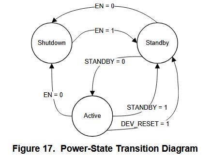

  • I found the issue. Apparently there was a typo in the code that calls the setting of the EN pin to high.
    So all the behaviour is caused by the driver never exiting the Shutdown power state:
    So the DRV2605L sets the OC_DETECT flag when you change the mode and set the GO bit but never set the EN pin.
  • Interesting.. Yes, the device may act strangely if EN is low, and you're writing I2C commands. From the datasheet: "The EN pin must be high to write I2C device registers. However, if the EN pin is low the DRV2605L device can still acknowledge (ACK) during an I2C transaction, however, no read or write is possible."
