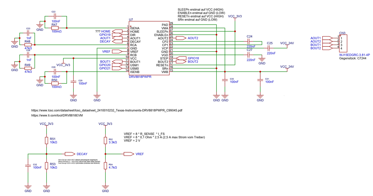

I’m trying to drive a bipolar stepper motor with a DRV8818 using STEP/DIR from an ESP32-C6-DevKitC-1. I’ve attached my schematic and can also share the minimal firmware if useful.
Setup
  • MCU / FW: ESP32-C6-DevKitC-1, PlatformIO (Espressif32 6.8.1), ESP-IDF 5.3.0, 3.3 V logic
  • Driver: TI DRV8818
  • VM (motor supply): 24V
  • Sense resistors: 0.10 Ω (per phase)
  • VREF measured: ~2.0 V → I_trip calc ≈ Vref / (8·Rsense) = 2.0 V / (8·0.10 Ω) ≈ 2.5 A
  • Decay: Mixed
  • Microstepping: USM0/USM1 both fixed to GND -> fullstep.
  • Control pins (default states):
    • ENABLEn: LOW (driver enabled)
    • SLEEPn: HIGH (awake)
    • RESETn: HIGH (held high)
    • STEP/DIR: from GPIO 18 and 19

  • Hi Tom,
    Thank you for reaching out to us.
    The schematic appears correct. Could you please describe the issue you're experiencing with the DRV8818?

  • Hi Mojtaba,
    I used the DRV8818EVM as a reference for my design, but I can’t get the stepper motor to rotate—the motor only makes an unusual buzzing noise. I’m not sure what I’m missing.
    Could you share a minimal code example (e.g., Arduino/C with register/settings) that reliably drives a stepper with the DRV8818, so I can cross-check my setup?

  • Hi Tom,
    If you are hearing buzzing noise, it seems that the output voltage is generated.
    What is the motor spec? Resistor, inductance, current?
    Can you capture the input step pulse, and output voltages?
    can you check that power supply can provide enough current as well?
     We do not have codes for Arduino, however, you can download the FIRMWARE code MSP430 microprocessor from following link.
