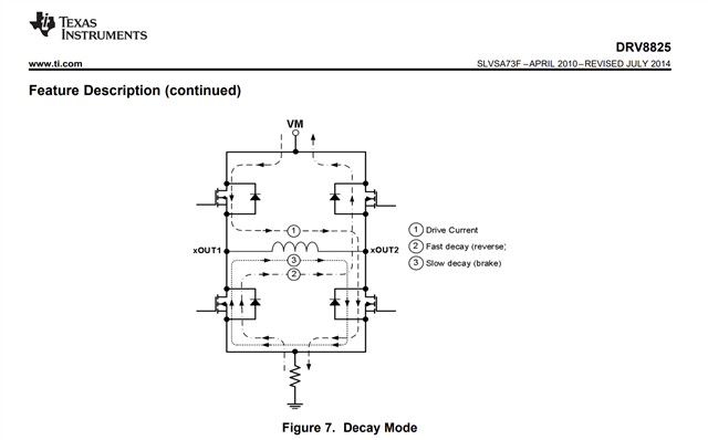

Customer is verifying DRV8825 on their board, but they found that ISENA waveform is not linear. Is it normal waveform? If yes, please explain me on it. If not, please let me know how to improve it.

Thanks for your question. The ISEN is on the LS-FET source. It will not match This looks normal. It will not sense current during slow decay as the recirculation current will be via the two LS-FETs. See below.
