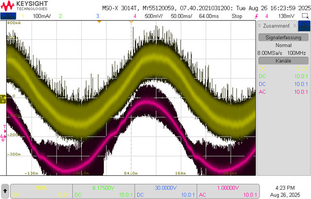

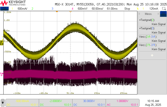

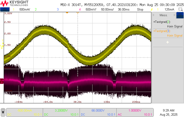

The problem is, that there is very noticeable distortion of the phase voltage around the zero crossing of the current. This in turn leads to distortion in the current which is detrimental to our motor controller.
The following screenshot shows the current of phase A (CH1, flowing from driver to motor), and the corresponding low passed phase voltage at OUTA (CH4, through RC-lowpass and AC coupled) for an open loop sinus voltage:
The waveforms look similar to the "zero current clamping distortion" effect. It is my understanding, that the delay compensation feature of the DRV8316 is intended to remedy the distortion of the output duty cycle as mentioned in the last chapter of this application note https://www.ti.com/lit/an/slvaf84/slvaf84.pdf. However, we can measure that the output duty cycle at OUTA is smaller than the input duty cycle at INHA during the distortion.

We conducted some more experiments:
  • reducing PWM frequency: effect vanishes at around 20kHz
  • increasing delay target: no improvement
  • reducing delay target: more distortion until distortion of whole waveform
  • reducing slew rate: not much of a difference, lowest setting distorts whole waveform
Do you have any experience with this effect, and is there a way to prevent the distortion? Do you agree that the delay compensation feature is intended to prevent the distortion?

    I will add screenshots to verify the exact delay between input and output PWM. I think that the delay target was met relatively well at first glance. At first I was also suspicios whether maybe some PWM cycles are missing or the supply voltage dips but this is not the case. You can see from this persistance shot for example, that there are no very short or missing pulses due to an overcurrent situation or similar, and you can also see a jitter in the delay of the rising edge (CH2 INHA, CH3 OUTA):
    However, the sinus that I am running as a test only has an amplitude of 4% duty cycle (notice the range in the persistance view). This means that even small distortions lead to significant changes in the voltage. We noticed that, because a 0A setpoint in our motor controller is a valid operating point and it becomes noisy at high PWM frequencies.
    I also previously tested some intermediate frequencies. I do not think that it is a binary effect but that it becomes less and less noticeable. Maybe it was also ok in the 40kHz range already but it gets harder to tell because the current ripple also increases.
    To me it feels like the delay compensation feature is only precise to a certain constant limit/quantization. And this becomes more relevant as the periods get shorter. Notice that the 100ns range jitter that was mentioned in the related thread would already be 1% duty cycle at 100kHz. So some timing effects in this range seem realistic.

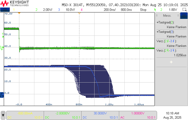

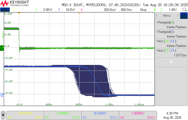

    I also did some more measurements and changed around the setup a bit so that the effects can be better isolated. The measured channel A is held steady at the center of the sinus which is still running on channel B while channel C is disconnected:
    Again current (CH1) and low passed voltage (CH4) at phase A:

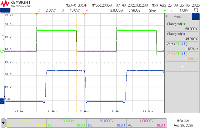

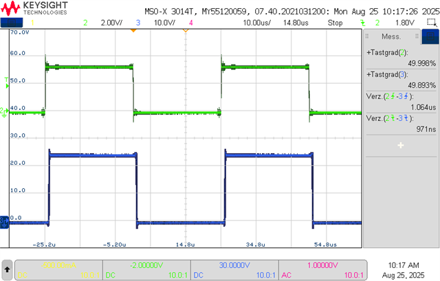

    Now for the measurements of the effective delay that you requested (still configured to 1,2us).
    Good case (1.18us rising, 1.15us falling edge):
    Bad case (1.06us rising, 0.99us falling edge):

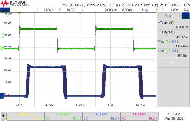

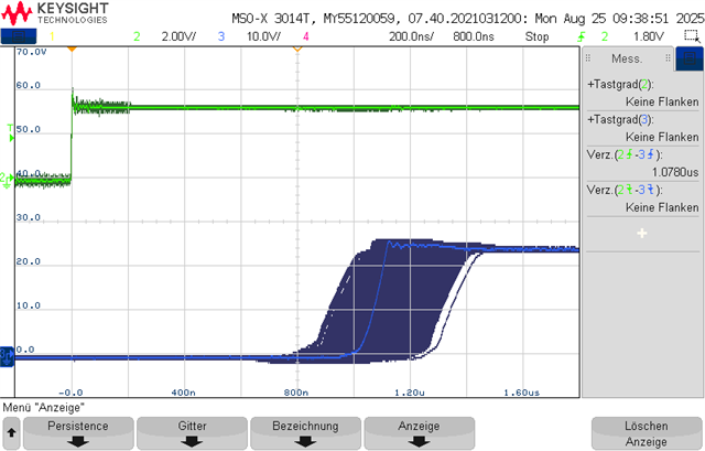

    Now to check again for stable 50% duty cycle at the input, and varying duty cycle at the output with a persistance view:
    Varying delay for the rising edge:
    And for the falling edge:

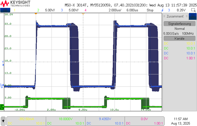

    And now for the same setup but with 20kHz instead of 100kHz:
    With persistance view:
    So I would say that the precision of the delay compensation stays the same over the frequency range, its impact just grows for smaller periods. Also the effect at zero crossing still persists, it just gets less noticeable relatively, and negligible for our use case.

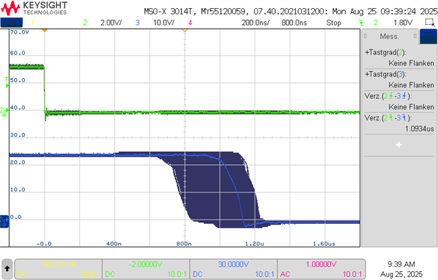

  • Hi Joseph,
    I think we have to evaluate for ourselves now, how we can deal with the behavior. For clarity's sake, in your opinion there is no SPI parameter that we missed which could remedy the distortion?

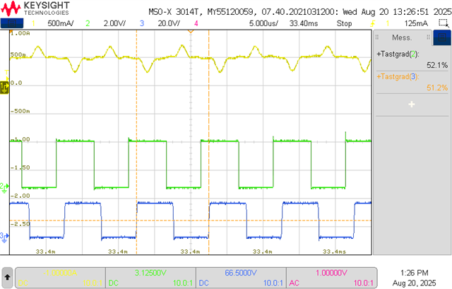

    As there are some variants of motors to control, I now checked a motor with the following parameters:
    • phase to phase resistance: 11.3Ohm
    • phase to phase inductance: 98uH
    The distortion in this case looks much better at 100kHz:
    Now again for the experiment with phase A at 50%:
    It looks like the jitter in the rising edge is improved, maybe also the amount of time that the signal is in the middle of the tolerance. Because the total waveforms look better - especially the current.
