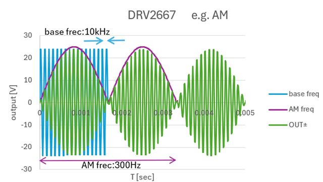

We are planning to use the DRV2667 in our upcoming project.
Could you please provide information on the setting ranges for both the resonant frequency of the piezoelectric element (as the base frequency) and the AM modulation frequency? The reason for my inquiry is that while the specification sheet mentions a maximum of 500Hz, it does not clearly specify which frequency this limit applies to. I would like to use a base frequency range of 100kHz to 600kHz, with an AM frequency range of approximately 1Hz to 500Hz.
Thank you for your assistance.
DRV2667_AM
    Modulating at these high frequencies should not be an issue. This was designed for haptic devices operation in the <500Hz range. Any high frequency content up in the 100kHz range will be rejected.
    The datasheet has two specifications to help understand this:
    1. The C_L (load capacitance) table, section 6.3. This specification can be interpreted as the bandwidth of the device per the setting
      1. For example, at VBST = 105 V, Frequency = 500 Hz, VOUT = 200 VPP, you can drive a 50nF load
    2. The open-load bandwidth, no load, is further down in the datasheet, section 6.5.
      1. At 100Vbst, 200Vpp, the un-loaded bandwidth is 5kHz.
