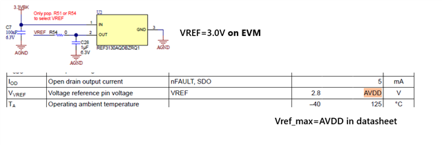

As AVDD is 3.3V, external voltage for VREF must be lower than 3.3V for some headroom(to consider AVDD 3.3v output accuracy) . Is it right?
Hi Ken,
You are correct, VREF should not exceed AVDD so having VREF at 3V would be a good option but you can also use AVDD to supply VREF?
