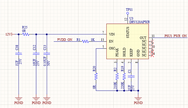

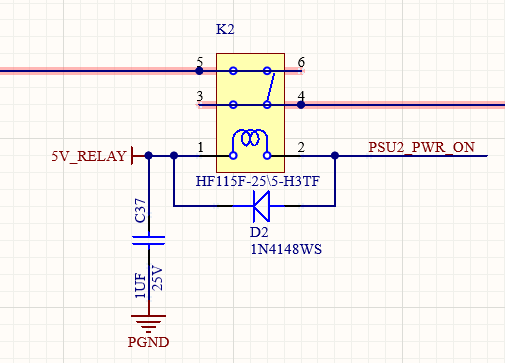

Hi, Team

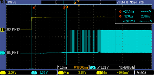

Customer is testing our DRV120 about the Start-up delay(tD) , datasheets shows the delay is about 25us.
But their test result shows it have about 25ms. Why is this test result so different from the spec? Are we missing something important?
Thanks.
