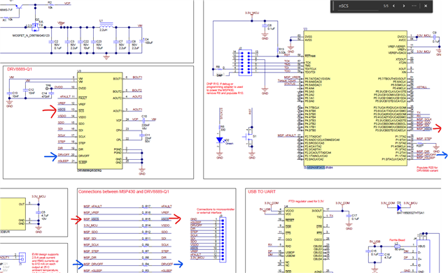

HI team,

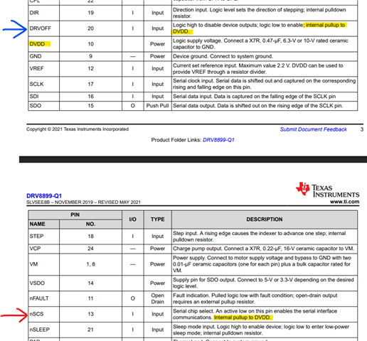

Is it no problem directly (0ohm) connection between DRV8899-Q1 and MSP430F261X-PM64 such EVM default connection?

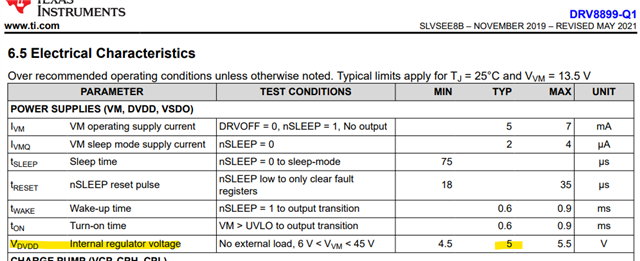

DVDD is 5V, DRVOFF and nSCS is pulled up to DVDD internally.

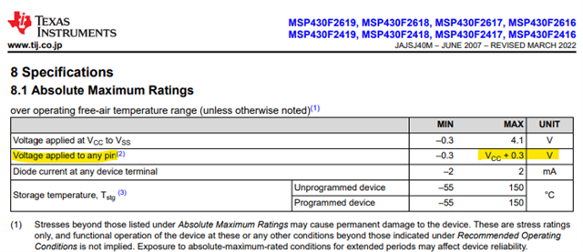

On the ohter hand, MSP430F261X-PM64 has VCC+0.3V absmax.
Ochi

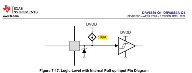

    This is a non-issue. The internal pullup to 5 V DVDD is a weak 10 μA equivalent of 500 kΩ.
    This would be easily overridden by the 3.3 V output of the MSP430 IO pin. The 10 μA current cannot cause any damage or malfunction to the MSP430. Thank you.
