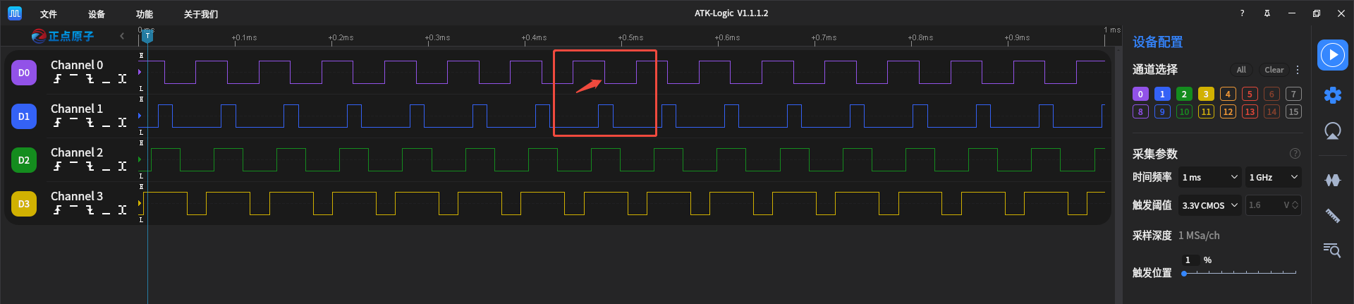

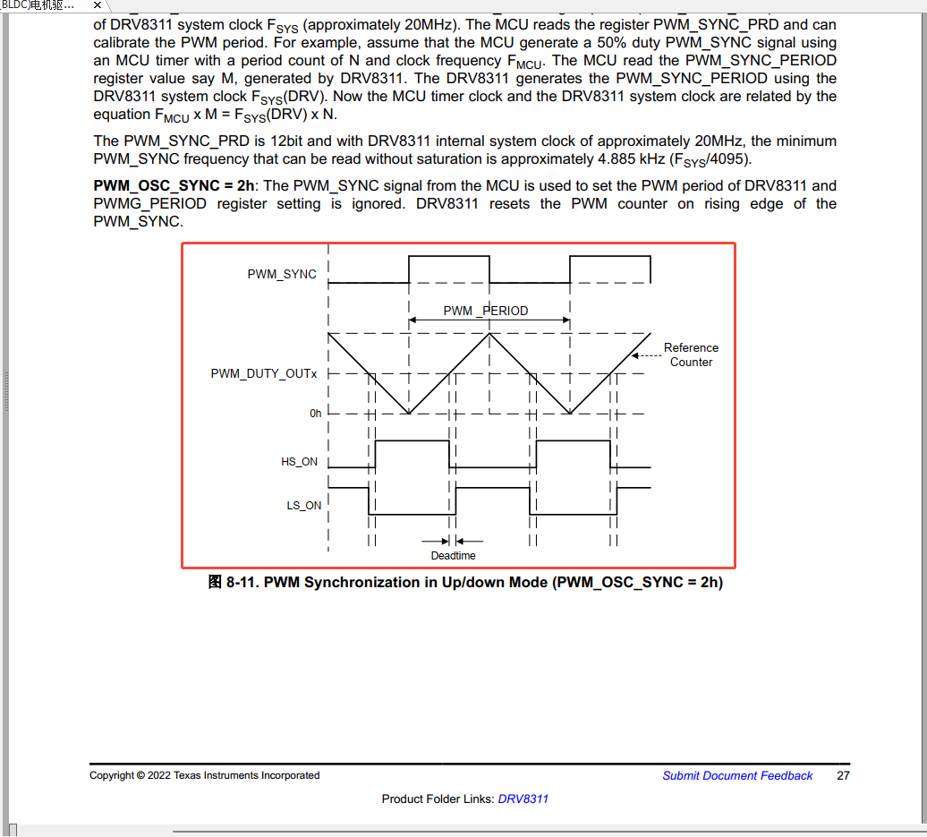

Hi team,
According to the specification sheet, during the falling edge of the PWM_SYNC synchronization signal, the upper bridge HS is closed and the lower bridge LS is open, and the U-phase should be at a low level. Why is the actual waveform collected at a high level? Is it a configuration issue?
Channel 0 is PWM_SYNC, and Channel 1 is the voltage of U relative to ground.
