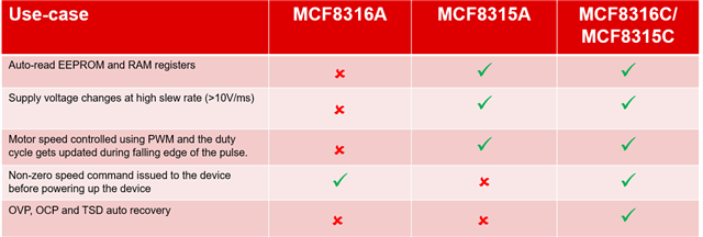

MCF8315A: MCF8315A/C/D -- Differences and EVM
Part Number: MCF8315A
Other Parts Discussed in Thread: MCF8315D, MCF8315C, , MOTORSTUDIO
MCF8315D: MCF8515A vs MCF8315C vs MCF8315D
I would like to understand the differences between the 3 variants
And which version comes in the evaluation module
because the product page for both MCF8315A / MCF8315C both list the same EVM module
with the only difference being the IC package.
and the evaluation module doesn't clarify the version used
