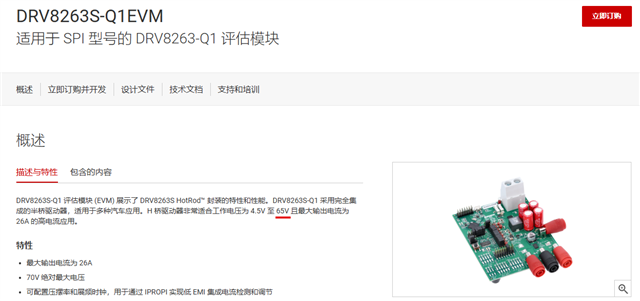

Is DRV8263S-Q1EVM available for 48V operation?
Seeing from EVM users guide, we cannot support 48V.
In the website it is said the max. operational voltage is 65V.
Hi Liu,
The DRV8263x-Q1EVM was designed so that it can support the full range of the device, so it can even support 70V. This statement will be updated in the DRV8x63x-Q1EVMs User's Guides.
