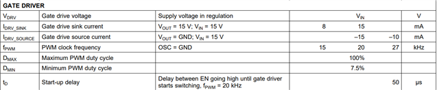

I am developing a product that includes solenoids. There will be two driven in parallel.
Specs are
Supply Voltage - 24VDC
Coil Voltage rating - 12V
Coli Resistance - 2.5Ohms
I would like to increase the EVM capabililty with an external mosfet, but retain Pick and hold control as seen with the EVM.
Since the FET will be external, will I be able to use wire rather than a PCB to connect the FET to the EVM, solenoids and 24V supply?
Demo is expected some time next week so I don't have much time to implement this.
Thanks for any help you can provide.
Jim Brooks

    Although TI has not formally tested this specific configuration, we can offer some general guidance. When wiring external FETs, it's essential to consider the potential impact of parasitic wire inductance and resistance on the overall performance. To minimize these effects, you may want to try using short, thick, and twisted wires for a quick demonstration.
    Additionally, it's crucial to ensure that you're providing the required average gate current (IGate_AVE) to properly turn on the MOSFETs.

  • This is what I was worried about. I am using the DRV110EVM and planning on replacing the stock FET with a 20A rated part (lower RDSon) This of course means higher gate capacitance. The FET I am planning on using is the Infineon IPD038N06NF2S. Gate capacitance is 3000pF at 1Mhz. I don't have the solenoid inductance yet. Will this exceed the drive capability of the DRV110?
  • Hi Jim,
    The DRV110 can provide 15 mA for gate driver. Please use the reference design below to calculate the IGavg for choosing the appropriate resistor based on your switch.
    Current Controlled Driver for AC Solenoids (Rev. A)
    best regards,
    Mojtaba
