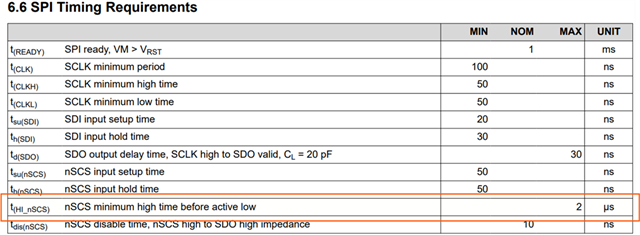

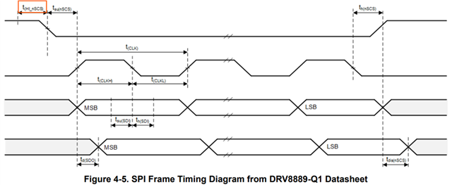

My customer want to confirm the SPI AC timing requirement for DRV8889 motor driver.
The “t(HI_nSCS)” is required 2us as maximum, but explanation for this parameter mentions that it is minimum time as you can see below.
◆DRV8889 data sheet rev.D
◆Daisy Chain Implementation for Serial Peripheral Interface (Rev. A)
Can you please confirm if this is correct?
