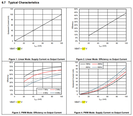

Hi Ti,
According to the datasheet, we should be able to achieve an output current of 102mA with 3.3V as input. However, in our testing, we are only able to reach 82mA at 3.3V. To achieve the full 102mA as output, we are increasing the input voltage to 4.2V. Our requirement is to achieve 102mA output current while operating DRV201A with 3.3V as input.
Based on the the datasheet the recommended Vin voltage is 3.7 V as can be seen below. Would you please test the device with 3.7 as well.
Mojtaba.
Hi Ti,
We have provided 3.7 V as Vin, but we are only getting 91 mA as the output current..
The current is controlled by VCM_CURRENT [7:'0] register.
Did you confirm that the registers are set up correctly?
Please share the output current, Vin, and register bits values.
