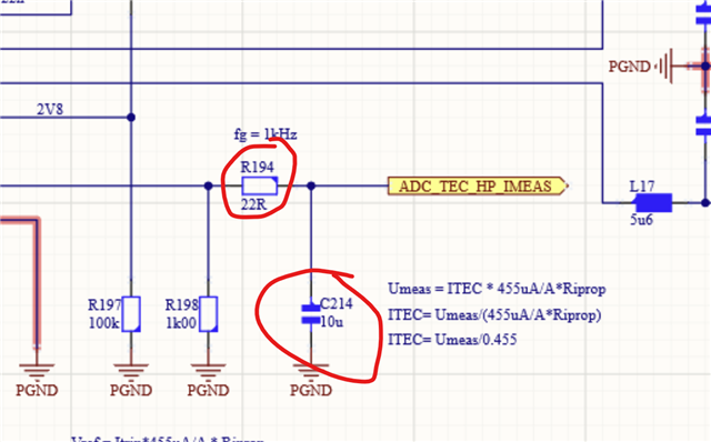

    IMODE 10kOhm to GND
    You mentioned IMODE was 10 KΩ to GND. But the schematic shows 0 Ω. Please check. The current regulation TOFF for this device is 25 μs. 30 kHz PWM period would be 33.33 μs. For 20 % duty cycle the on time would be 6.67 μs not enough time for a full TOFF if IMODE = GND. You could use the cycle-by-cycle mode but RIMODE must be either 20 kΩ or 62 kΩ to GND. In these modes the PWM frequency may have to be increased for proper current regulation - the point here is the off time must be shorted than the TOFF of 25 μs. See section 7.3.3.2.2 Cycle-By-Cycle Current Chopping in the datasheet.
    Lastly the RC filter on the IPROPI seems like a load because the charging current would be so low for such a high value capacitor. You may want to increase the R194 significantly and reduce C214 or insert an opamp buffer. The AIPROPI for this device is 450 μA/A. Loading on the IPROPI would impair current regulation operation, its response time.

    I changed the IMOD resistor to 20k (to GND). the output filter is now R194 = 1k, C214=100nF.

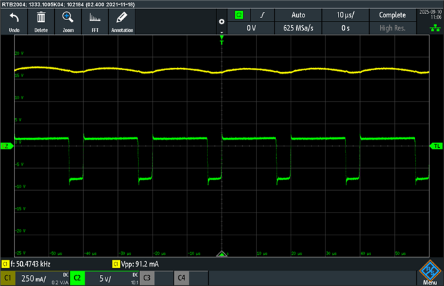

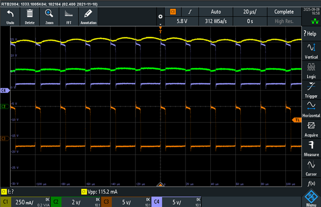

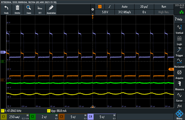

    Attached you can find two plots for the output filter configuration: Caps parallel to TEC, not to GND. As given in the second picture of the initial post
    Yellow: Current trough TEC
    Green: Voltage accross TEC
    Orange: TEC_N voltage wrt GND
    Violet: TEC_P_voltage wert GND
    DIR=0, fsw80kHz, DC=0,2
    DIR=1, fsw80kHz, DC=0,2
    The used inductors are 74439346056 from Würth with a nominal current of 8A. Nevertheless, at DC 0.4 they get a temperature of about 65°C.

    I changed to cap configuration as given in the first picture, with all caps to GND.
    The ripple current is doubled, and the temperature rises up to 70°C.
    thanks
    philipp

    The output of the DRV8874 or similar brushed motor driver full-bridge would be a PWM output aka square wave. The LC filter (second order) is used for cleaning up the ripple in the current.
    This is the commonly used configuration for filtering in a TEC driver. Either topology is fine, but the second picture connection doubles the effective capacitance of these capacitors across the TEC hence lower ripple by ~ 2x.
    The scope captures look normal to me.

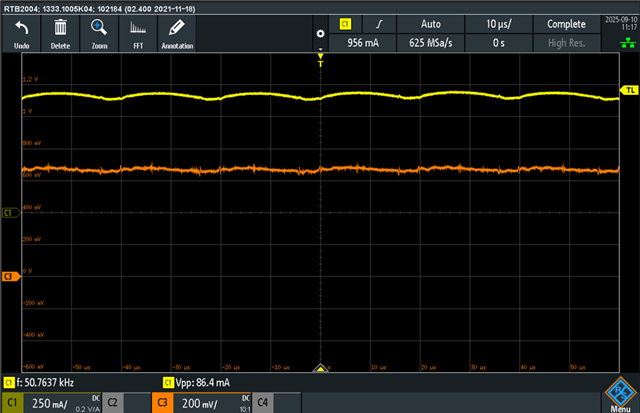

    I measured the Imon port: (orange voltage at Imon)
    Something about 700mV. The DMM and current clamp give my a DC current value of 1A (ca).
    The computed current is higher: Itec = 0.7V(455uA/A*1k) = 1.5A
    There is still a missunderstanding from my side about the behaviour of the current trough the inductor. And the temperature corresponding temp. rise.
    This represents the total current via the LS-FET to GND of the conducting LS-FET. Increasing the value of the series inductance, for example to 22 μH and reducing the total capacitance to 22 μF or even 10 μF would increase the impedance of the inductor at the PWM frequency (80 kHz), keep the cutoff frequency in the same range and reduce the power lost in the filter and still keep the TEC current ripple to a reasonable value. Thank you.
