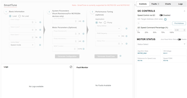

Assuming the missing components on my PCB can be omitted, I try to begin with SmartTune. The display is grey, inactive. I eventually get a CONTROLLER_FAULT and an MPET_BEMF_FAULT.

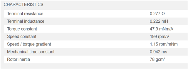

The bus voltage is about 24V. Here's the specs on the motor connected to the EVB:
    >>SmartTune support for MCF8329A is under development, updated version will be released by end of this month.
    Please share your motor's number of poles, we can help you with the default JSON file which you can use as the base.
    Dhinesh
  • Hello Dhinesh,
    the motor has 8 poke pairs.
