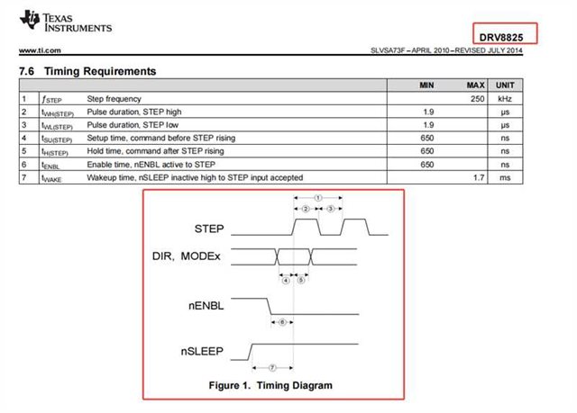

Dears,
    My customer want to know the timing requirements of Enable,Sleep, APHASE,BPHASE, which is similar to the screenshot of DRV8825. I can't find this in the datasheet.Could you pls help? Thanks.
  • Hi Jon,
    The timing requirements between these two devices will be different due to the different interface types. The DRV8812 has a PH/EN interface while DRV8825 has a STEP/DIR interface.
    The DRV8812 has an internal PWM frequency of 50kHz.
    Is the customer having trouble implementing a specific step sequence?
