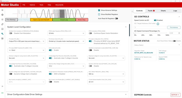

MCF8329RRYEVM: MPET does not terminate and the motor does not rotate.
Part Number: MCF8329RRYEVM
I am using the MCF8329RRYEVM.
The motor I want to connect and use has the following specifications:
Motor: FL28BL26-15V-8006AF
  • Rated Voltage: 15 VDC
  • Rated Current: 0.51 A
  • Peak Current: 2.5 A
  • Line-to-Line Resistance (@20℃): 8.2 Ω ±10%
  • Line-to-Line Inductance: 2.3 mH ±20%
  • Torque Constant (Kt): 13.7 mN·m/A
  • Back-EMF Constant (Ke): 1.06 Vrms/Krpm ±10%
  • Rated Output Power: 6 W
  • Rated Speed: 8000 RPM
  • Poles: 4
  • Winding Type: Star (Y)
In Motor Studio, I configured it as follows:
  1. System Level Configuration
    • FG Division factor [FG_DIV]: Divide by 2 (for 4-pole motor mechanical speed)
  2. Control Configuration – Motor Parameters
    • Motor Phase Resistance: 8.2 Ω
    • Lq: 2.3 mH
    • Ld: 2.3 mH
  3. Motor Parameters
    • Maximum Speed: 200.00
    • Maximum Bus Voltage: 15 V
When I run MPET, the motor seems to twitch but does not rotate.
Did I make a mistake in my configuration?
I’ve also attached the JSON file for reference.

    MCF8329 RRY EVM comes with 5mohms shunt resister but the JSON which you shared has base current configuration for 1mohms.  Base current configuration is located in GD_CONFIG2-> BASE_CURRENT.
    Modified JSON attached here. could you please try running the MPET using this JSON?
