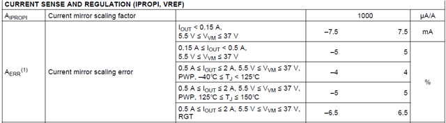

My customer now wants to use DRV8231A as motor driver. And they have accuracy requirement as Iout < 0.05A; error < 5mA. and Iout< 0.15A error as 10mA.
The DRV8231A absolutely cannot achieve such accuracy. Could you give us some suggestion in how to improve current test accuracy to meet customers needed.

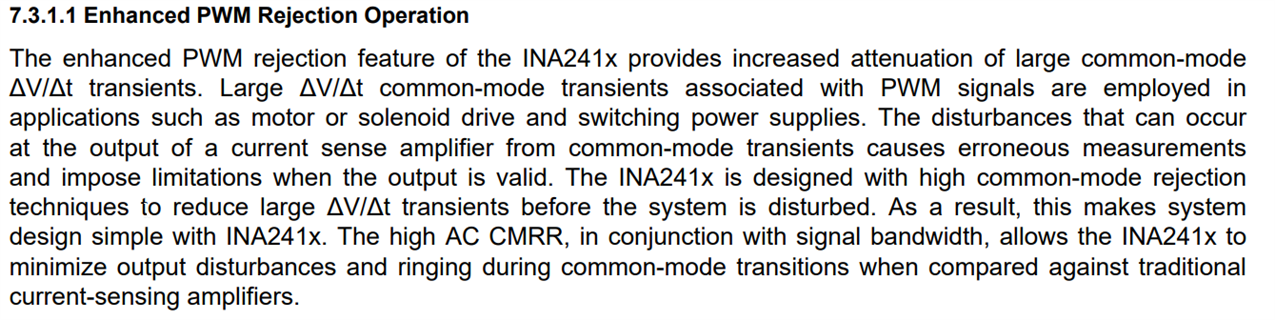

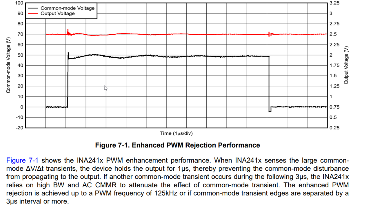

  • Hi Peng,
    If they are using an external I recommend the INA241 due to the PWM.  I would also verify that the switching is under 125kHz.  Otherwise use the INA296 and live with the transient at the output due to the VCM changes.
    Below are some information about the enhanced PWM rejection of the INA241A which is in the datasheet.

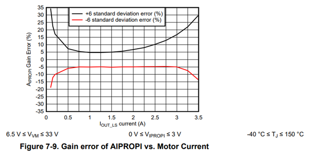

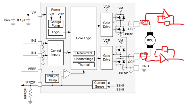

  • Hi Peng,
    I understand that using an external solution isn't ideal but all current sense paramters are integrated into device. The DRV8231 is a hardware (GPIO) device so no SW changes can improve current accuracy.
    What level of accuracy are they looking for?
    The DRV8876 has a better current sense accuracy because it has a smaller current mirror scaling facotor (AIPROPI). A larger scaling factor amplifies not only the desired signal but also any errors or noise present in the input current. This can result in a larger absolute error in the output current, which can degrade the accuracy of the current sense circuit.

  • Hi Peng,
    It is recommended that the customer test the device accuracy under their specific operating conditions. The datasheet specs are across voltage and temperature so it's possible to see better accuracy under certain operating conditions.
    Yes, it would be possible to zero by SW externally if the customer is willing.
