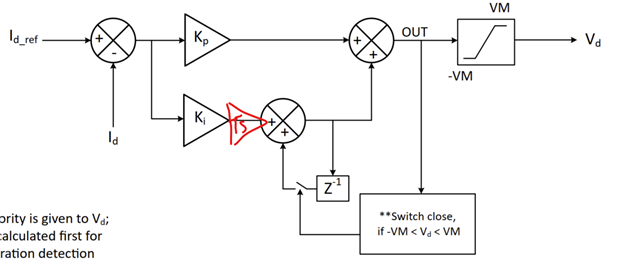

  • Hi Dhinesh,
    thanks for answering, this is what I was looking for! Is this information available in a document which I did not find?
    The second question is whether the discrete integrator is considering the discrete sampling time Ts= 1/ADC sampling freq? It is not visualized in the datasheet but I am quite sure it is as these are gains designed for continuous control.
    Something like this:
    Manuel
  • Hi Manuel,
    Yes, Ts is inverse of current sampling frequency.
    For MCF8329A, current sampling frequency vs PWM frequency table is slightly different.
    PWM switching frequency- fPWM (Khz) current sampling frequency (Khz)
    <15 fPWM
    20 to 30 fPWM/2
    35 to 45 fPWM/3
    50 to 60 fPWM/4
    70 to 75 fPWM/5
    Dhinesh

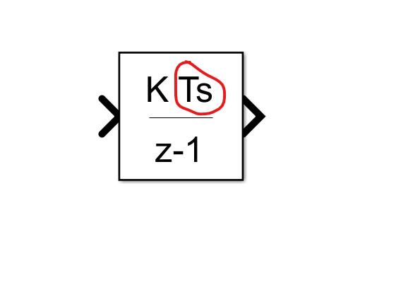

  • Thanks Dhinesh,
    but what I was referring to is that a discrete time integrator is dependent on Ts. Either it has to be considered in Ki (which I do not think as it is designed for a continuous controller)  or in Figure 6-27 ff the sampling time Ts is missing. Am I understanding it correctly, that it is not pictured but the internal algorithm is calculating like that?
    Manuel
  • HI Manuel,
    You are right, Ts is not highlighted in the picture but device algorithm using it internally for calculation.
    Dhinesh
