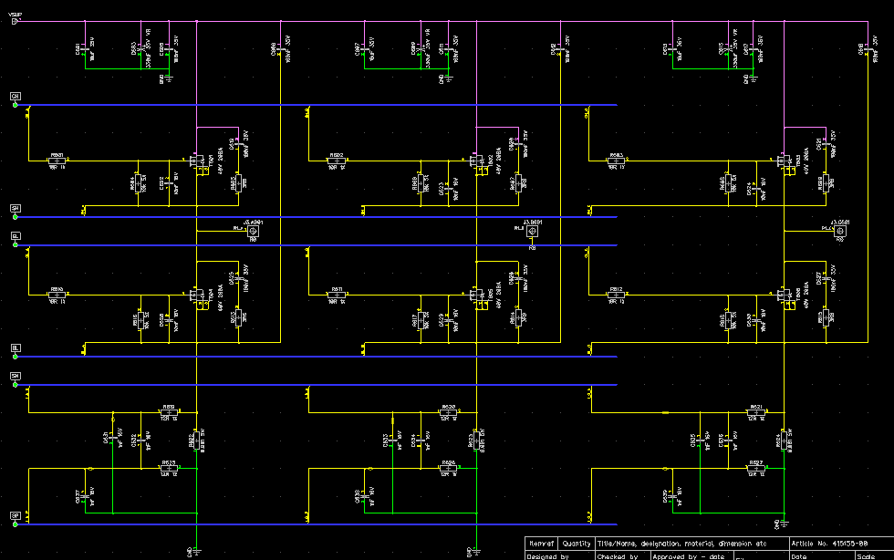

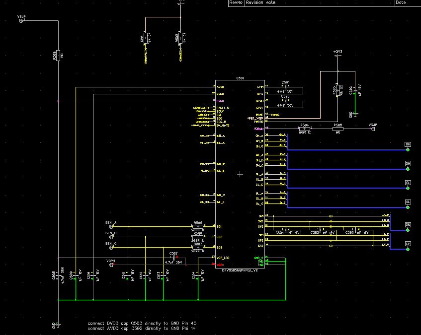

Here the Schematic:
and the schematic of the power stage:
Neither the chip nor other parts are exceptionally hot, but maybe 2 °C warmer as compared to the earlier version of the board.

  • Hi John,
    Although the schematic is a little unclear, it looks like VCPH to PVDD cap is 4.7uF with a 35V rating?
    In the previous E2E it was mentioned that the rating should be PVDD x 2. It could be that your capacitor is being de-rated?
    can 0603 caps fit on your board for CP1 and CP2? This would be a good test to do is seeing the behavior on the same board with the different sized capacitors.

    The VCPH to PVDD cap used is a takeover part from the board where the DRV8305-q1 is working as expected. From the previous E2E, I understand that CP1 should be rated for PVDD and CP2 should be rated for PVDD x2. Both of the caps CP1 and CP2 are rated for 50 V.
    In the previous E2E, I have not seen a rating for the cap VCPH to PVDD x 2. The datasheet for the DRV8305 SLVSD12D is showing 2,2 μF rated for 16 V for the VCPH to PVDD cap:
    Please confirm PVDD x2 for VCPH to PVDD cap.
    Good idea to try the 0603 size for CP1 and CP2. I soldered in the 0603 caps yesterday, but unfortunately no improvement. :-(
    I have checked the values of these parts and measured in circuit with an LCR meter to confirm. Everything seems to fit.
    On this version of the board, I have also closely followed the layout guidelines in section 10.1 of the datasheet.
