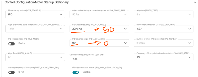

Edit: after trying multiple register config files from another thread it seems to be primary an issue with the configuration so this is now more a question on how I generate the right values for the registers.

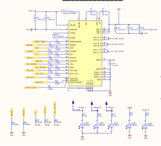

    Can you share custom board schematic (MCF8316 section).
    Thanks and Best regards
    Venkatadri S
  • The 0 ohm resistors are there for debugging flexibility and I have a pull up on both data lines (one being not shown)
  • Hi Paul,
    Can we verify with following changes to schematic
    1. Remove pull down resistor on DRVOFF and directly short
    2. Remove LED from Phase A, B, C section so that there should not be any capacitive effect on the IPD pulses.
    Venkatadri S
  • I have the LEDs off I removed them prior to most of my testing, the drive off 10k pull down has been shorted to directly connect that pin to ground
  • Hi Paul,
    I don't see any other issue in the schematic.

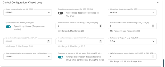

  • Hi Paul,
    I am commenting on 2nd JSON, there some changes needed for IPD setting
    Open loop setting
    Closed loop setting (I suggest disabling speed loop and test with torque loop for now, we will enable once you are able to spin)
    I modified the JSON for MCF8316C

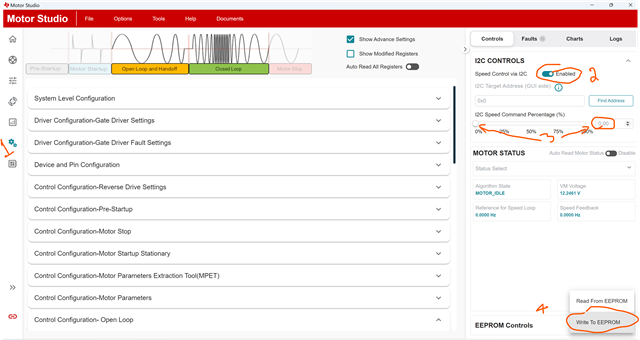

  • That file was able to get the motor running and I can somewhat adjust the speed using the I2C controller, it does seem to stall out at higher speed setting % but at low % it will run consistently.
    When I am in the (advanced tuning) and go to make a change to the register value do I need to click the "write to eprom" to update the register on the device itself?
  • Hi Paul,
    The JSON I shared is torque mode, speed is not regulated.
    If motor is on no load, speed can increase and if it crossed 170% of MAX SPEED, abnormal speed detection will trigger.
    You can reduce ILIMIT in the FAULT_CONFIG register or in the GUI Advanced tuning page -> closed loop settings.

  • For the torque mode how can I find the torque it is set to? I am assuming the I2C % interface is telling it what percentage of the maximum torque to set to?
    When I follow the steps and write to EEPROM this will allow me to preserve the register values after cycling power so in theory I could disconnect the I2C interface and just use a pwm to control the motor speed from say a FPGA or other device?
  • Hi Paul,
    Torque is coil current, if the ILIMIT is 8A which generates max torque for the motor.
    Yes, you can program to EEPROM and disconnect the GUI, control the speed through speed pin.
    Please watch the webex recording  https://ti.webex.com/ti/ldr.php?RCID=86fc0fff8d2726818542635fb5353db8
    Venkatadri S
