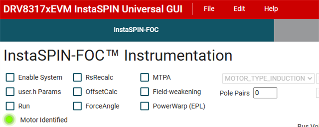

And I have successfully tested the sensorless FOC control with BLDC motor via GUI

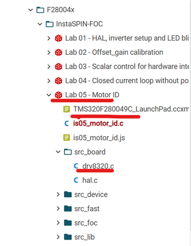

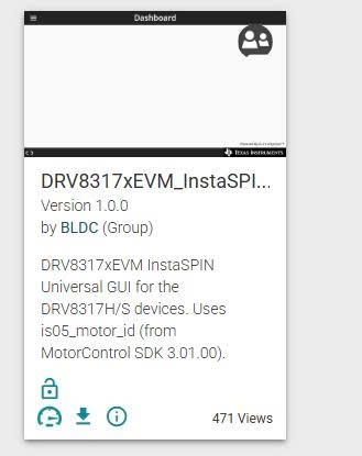

As mentioned in GUI it is using example is05_motor_id for deployment.
but I checked in this example only DRV8301 and DRV8320 ​​driver is supported.
I found that drv8320 is quite similar to drv8317 so I continued to build and download this program to LAUNCHXL-F280049C. And follow this guide (https://dev.ti.com/tirex/content/C2000Ware_MotorControl_SDK_5_04_00_00/solutions/common/sensorless_foc/docs/labs/MotorControl%20SDK%20InstaSPIN%20Lab%20Guide.pdf) to implement it . However, it cannot run BLDC motor as I did with GUI.

    This should be the right code in order to operate. Maybe the issue is that the GUI mentions SDK version 3.01.00 and you are using the 5.04.00 version. Can you try using the older 3.01.00 SDK version and see if the program runs correctly?
    Also, you made sure to follow all the instructions in the GUIDE?
    Since you were able to operate using the GUI, is it missing functionality that is causing you to switch to the SDK instead?
