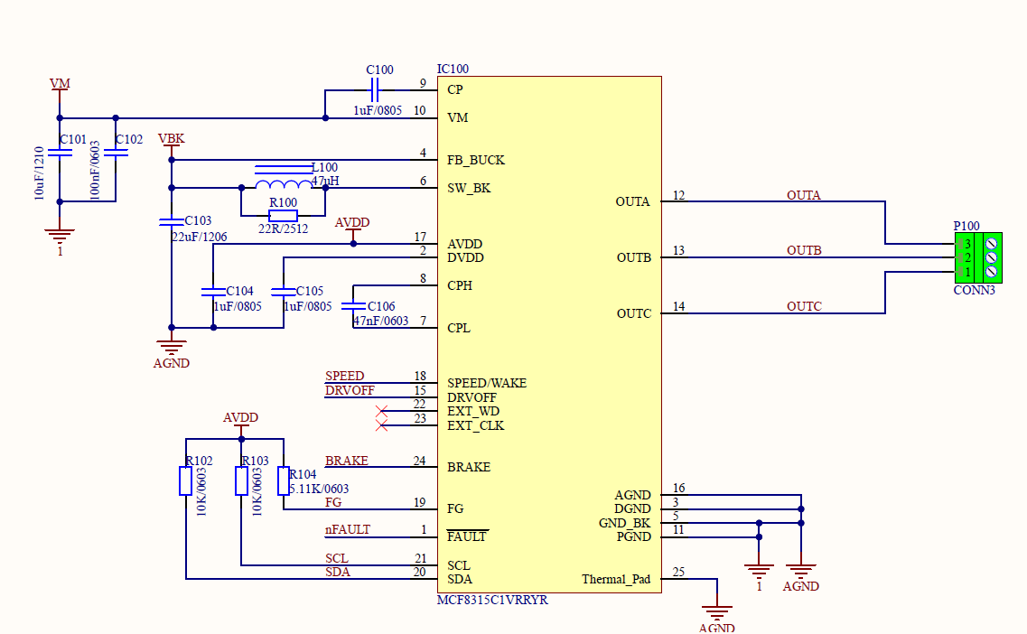

          However, on our custom fan motor driver board designed with the same controller MCF8315C1VPWPR, we are facing an issue. The motor runs only up to 330 RPM. When we attempt to increase the target          speed to 350 RPM or higher, the controller immediately asserts nFAULT and the motor stops.

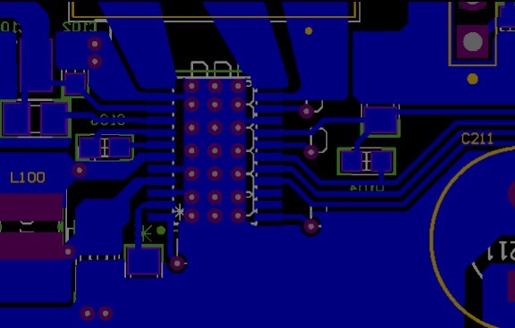

    What is the current above 330 RPM expected, is thermal pads are designed properly on the custom PCB? Please share the PCB layout if possible.

    B.  In 330 RPM above expected is 1.5A above. Yes I think thermal pads are designed properly on the custom PCB. I attached below Please verify this,
    TOP & BOTTOM LAYER
    TOP LAYER
    In Custom board, we tried to increase above 330 RPM the CONTROLLER_FAULT_STATUS Register is SET automatically and nFault error Occurs.

  • Hi Rahil,
    PCB layout is good and thanks for reading the controller fault.

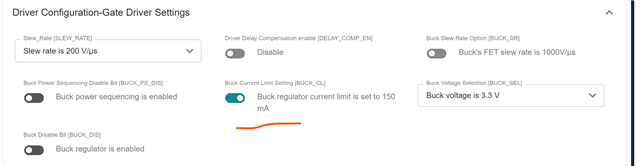

  • Hi Rahil,
    I looked at JSON and find it needs improvement.
    1. Buck if you are using resistor, buck closed loop current should be 150mA

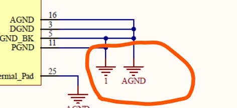

  • Hi Rahil,
    The configuration is for MCF8316C? The current limits are 8A in HW LOCK limit, ILIMIT is 5A and so on.
    Is it possible to capture any one phase current while running and try to capture when the HW lock limit occurs? May be with 100ms time scale good enough.
    I don't see issue with fault configuration setting, only concern is whether any ground reference issues.
    We will also re check layout, can you point GRN "1" and AGND near the device?
    Since you are able to verify with EVM working properly, I want to verify ground and also phase current (capture with EVM as well)
    Why we need this? If there is any noticeable oscillation at higher speed which can trigger such faults. R, L may not be proper, ground reference as well.
