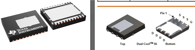

Hi, I recently used the BOOSTXL-DRV8323RS to prototype some BLDC motor controller. Then I basically copied the BOOSTXL Board but changed the MOSFETs to higher power MOSFETs. This is the part number: NTMFSC0D9N04CL. I am trying to run Lab02b just to test my custom PCB but the motor draws a lot of current during calibration and calculated the Rs value as basically infinity. I added 4.7 ohm gate resistors but nothing changed. I also tried to change these values:

    I was asking about the user.h file because from my understanding that has some motor parameters stored in there. I'm not sure if there are any FET parameters stored in there but it would be worth it to take a look since the BOOSTXL-DRV8323RS was intended to be used with the original FETs CSD88599Q5DC and could have those values already populated.
    This could also potentially be a layout related issue. How did you copy the BOOSTXL-DRV8323RS layout if the footprint of the FETs are different?
    also the Qg and Qgd of NTMFSC0D9N04CL are roughly 3 times the value of Qg and Qgd of CSD88599Q5DC meaning you're switching a lot slower (higher switching losses and more heat)

  • I created a custom PCB while looking at the BoostXL-DRV8323RS schematic. I effectively just swapped the MOSFETs. I found the issue, I swapped the current sense capacitor and resistor for the LPF when assembling the PCB. It is now all operational.
