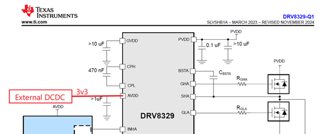

Hi Expert,
Have a nice day! I have question need your professional support:
Customer wrongly connect AVDD to external DCDC whose VOUT is3.3V:
Can this also work normally? Any risks to DRV8329-Q1?
Thanks!
Leo Ma
  • Hi Leo,
    AVDD on DRV8329 is an output not an input. The device has not been tested in this configuration as this was not intended, so this could have unknown consequences. It is recommended that AVDD be disconnected from the 3.3V supply
    Yara
