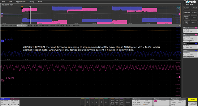

    1. The outputs AOUT1|2 BOUT1|2 oscillate when I enable the DRV8824 (i.e., the half-bridges are ON and see the motor) without commanding the DRV8824 to step. It also happens when stepping.

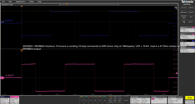

    2. If I use two 47Ohm power resistors in place of the stepper motor's two windings, I avoid the oscillations if I keep the power rail below 21V.

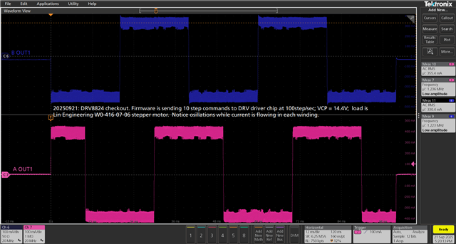

I'll also note that if the stepping is really slow (say, < 100steps/sec), the motor is able to step, since the oscillations only occur when the half-bridge is fully enabled; the phase windings are switching directions, and there is enough current to energize the windings in a static sense and perform a step. But faster stepping at higher rates is impossible.

DRV8824 NOT oscillating when driving 47Ohm resistors in place of stepper motor, and power rail = 14.4V, stepping at a very slow speed:

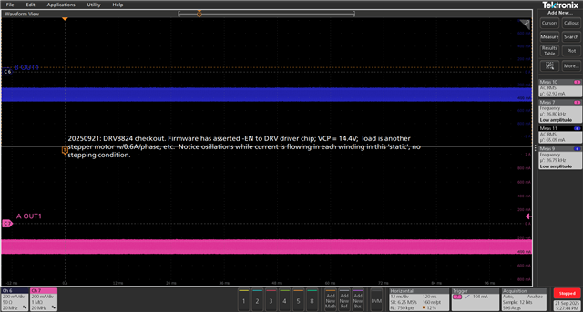

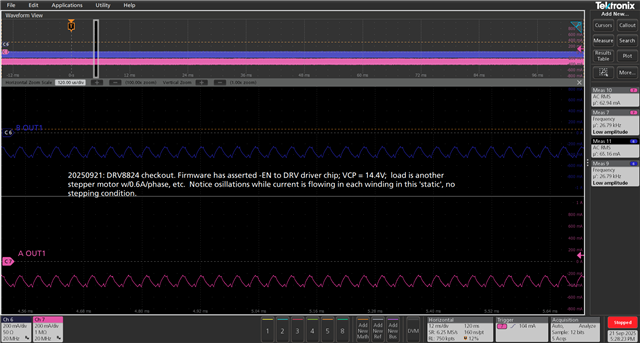

Now with stepper motor attached, power rail = 14.4V, no stepping, DRV8824 outputs are oscillating:
Closeup of oscillation:
Stepping at slow speed, power rail = 14.4V, with stepper motor connected:
Another view of slow-stepping with oscillations, zoomed in on the oscillation:

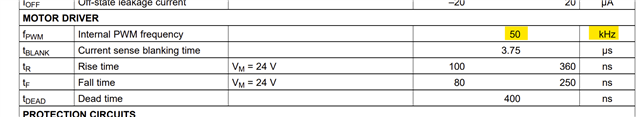

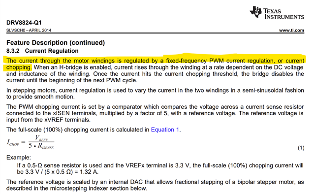

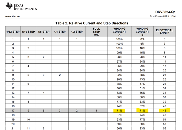

    This is normal expected behavior. You are referring to output voltages at AOUT1,2 and BOUT1,2. The DRV8824 is a constant current chopper regulated stepper driver. The stepper current is regulated by turning on tON and turning off tOFF the output voltages based on the motor current setting with the VREF, supply voltage and the motor L & R time constant. At power on or wake up from sleep the output currents for coil A and coil B are stabilized at 71 % of the full-scale current setting. See below. A fixed PWM frequency of 50 kHz is used for voltage / current chopping, the duty cycle is determined by close loop control. This will happen as soon as the driver is enabled without STEP pulses (holding current) and with STEP pulses (step or microstep currents per step). All constant current chopper stabilized stepper drivers (almost all of them today) will exhibit this behavior. You should capture the current waveform using a current sensor for each winding which is of relevance for stepper motors.
    The current regulation chopper expects L and R of stepper to be in a certain range for proper tON component in the PWM. With a resistive load L is absent and it impairs the current regulation. Stepper drivers are not meant to be tested with resistive loads.
    To repeat, I am seeing oscillations in a circuit that I believe has been implemented properly, with reasonably chosen components, even when I'm not stepping; i.e. the 'DC load' on the DRV8824 is driving it to oscillate.
    This is normal behavior as mentioned earlier. What matters are the current through the two coils. The currents would be a fixed value when STEP pulses are not input (STEP = 0) and current levels would match the step / microstep mode used when STEP pulses are present.

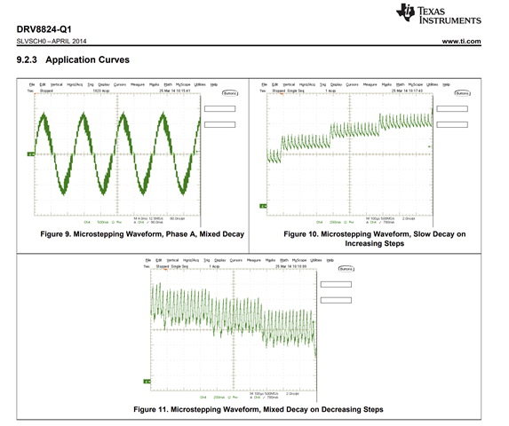

    All of the scope captures you shared are normal and match expected waveforms. The below waveform from the datasheet page-20 was captured with 1/8 step mode. In summary output voltage PWM is expected behavior. It is smoothed to desired current by the L & R time constant of the motor. Stepper drivers are not meant to driver pure resistive loads even for testing purposes.

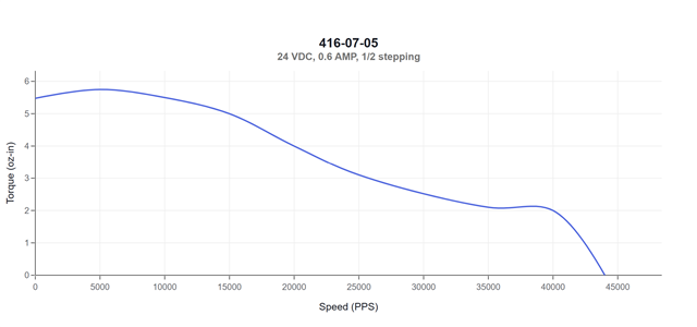

    Based on the speed vs. torque plot of the motor referenced it should be running fine at much higher than 100 PPS (pulse per second or steps/s). See below from the vendor. There may be other reasons such as load inertia in your setup that may have prevented the motor from spinning at higher PPS. To debug such issues we need to get the coil A and coil B current waveforms.
    These are current waveforms in full-step mode. Looks normal.
    These are hold currents with no STEP input. They're normal as well.

    I should have mentioned I'm only single-stepping.Can you elaborate on your statement "The currents would be a fixed value when STEP pulses are not input (STEP = 0) and current levels would match the step / microstep mode used when STEP pulses are present." I'm only single-stepping, what should this "fixed value" be? 0.71*programmed current? And a DC value when STEP = 0? Or a chopped value when STEP=0? I see chopped currents for STEP = 0 and STEP = 1.

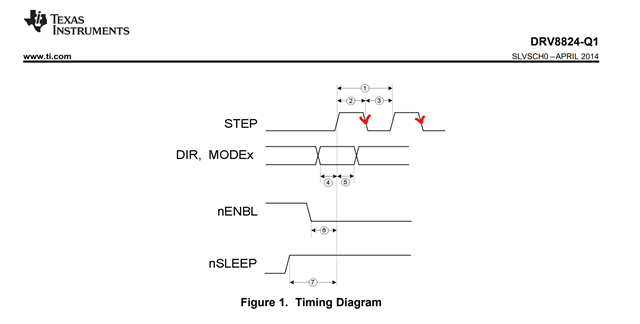

    This is good to know. When the device is powered up or woken up from sleep the first DC level of the current would be 71% of the set current in both A and B coils as per the Table 2, I shared in the last message. For every step 0->1->0 pulse the indexer will advance up or down the table depending on the DIR and the DC level would be the next corresponding level from the table for the step mode used. The chopped values would be present whether STEP is 0 or 1.  The falling edge of the STEP input would advance the indexer table. So normal state of STEP input should be 0 and one step pulse would be 0->1->0. For a STEP input 0->1 there won't be a change. For a STEP input 1->0 the indexer would advance by one step depending on the DIR logic level - motor clockwise or counter clockwise.
