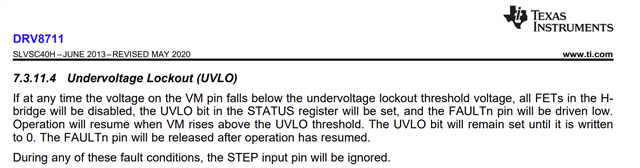

    Because the motor is operating normally, it does not appear to be an overcurrent OCP event. See below from the datasheet. An OCP detection would disable the outputs.
    You mentioned the STATUS was 0x0521. Plugging in this value to the bit fields of the STATUS register, I get a different inference. BIT0 is OTS, over temperature, set. However the motor was running normally. This means an OTS did not happen. Same thing with BIT5, which is UVLO, under voltage. This means the VM power rail went below UVLO threshold. If it was a real UVLO condition the motor will not operate. I suspect, your microcontroller may be having an erratic SPI transaction and reading incorrect bit values, perhaps due to incorrect SPI configuration.

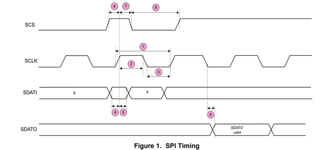

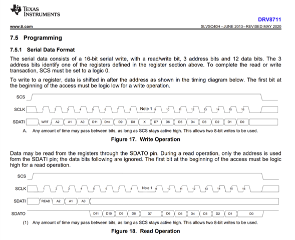

    Can you check the SPI transactions with an oscilloscope or an SPI analyzer and send the captures for review? They must be in compliance as below. If register write with SPI was the problem this could be the reason why your MOSFETs were not driven correctly because the settings may have been what you wrote to the registers. Let's verify this and confirm first. Also the RESERVED bit fields are usually 0 but you were reading them to be 0x5 (0x521).

    The order of the bits are reversed in your "Optional: decode specific faults" code. OTS is BIT0 of the STATUS register. Latched Stall detect is BIT7. In the future when you send register contents for review, please send the programmed hex values for each of the registers bit values. This will help avoid misinterpretation.
    Because of the reason the order of the bits were changed in this piece of code, can you check if all the registers' programmed values were of correct order?
    Are these fault bits (Channel B overcurrent, Latched stall) sometimes triggered during normal operation, or could this be related to SPI read timing or interaction between multiple boards?
    No, overcurrent will never be triggered unless there is a real overcurrent and when an overcurrent is triggered the motor will not be driven. This looks like an SPI read issue. This needs to be fixed. If you're using SPI, SCLK > 1 MHz you may want to bump it down to 500 kHz.

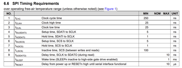

    Is there a recommended method to interpret or filter these status bits when using multiple DRV8711 devices in the same system?
    As long as the specified SPI timing requirements are met for each device there should be no issues with SPI communication.
    Do these flags indicate a real condition that requires corrective action, or can they be safely ignored if the driver is otherwise operating correctly?
    These flags are not expected without a real issue. This should be fixed. I do not recommend ignoring errors. The only error that may be inconsequential is the STALL detection. If the threshold is not properly configured it would incorrectly detect a stall. A STALL detection does not disable the running the motor. Internal stall detection can be disabled by setting EXSTALL bit to 1 in the CTRL register.
