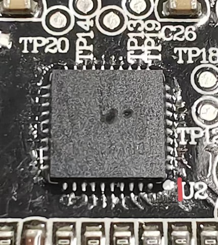

We have an 8323 that burned out during the customer's integration test. Could you please help provide the possibility of pre-drive damage?
There are two holes blown at this position

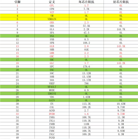

This is the impedance to ground .pls help me check where the problem is ?

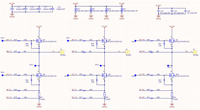

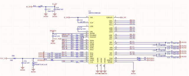

Before the pre-drive power supply, there is a tvs diode. The tvs diode has not been broken down. Below is the schematic diagram. Please help check where the design is wrong
