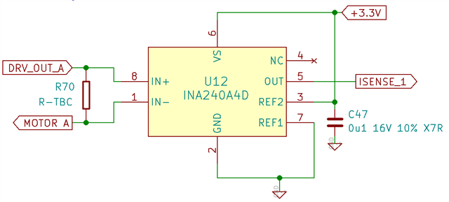

I am looking at a design with the DRV8962 to control a range of BLDC motors using FOC.
This requires more accurate coil current sense than is provided using the IPROPI pins so we are considering using the INA240A4D to measure the high side current. for the three coils. The output from the the INA240A4Ds will be fed into the ADC inputs of the microcontroller controlling the DRV8962.
The logic level supply voltage for the MCU,  INA240A4D and DRV8962 is 3.3V, the ADC input range is nominally 0V-3.3V
Is this a recommended way to do the current sensing in this application?

    You are free to choose whichever method of current sensing is suitable for your needs, no issues. However, keep in mind the on-chip IPROPIx is used for internal current regulation. If you don't need this internal chopper regulation to be active, which seems to be the case you must connect all the IPROPIx pins to GND and input VREF > 0.05 V, for example you can connect this to 3.3V. This will ensure the internal current chopping Itrip function is disabled.
    For BLDC application please make sure the fixed dead-time of 300 ns of the DRV8962 will be suitable for your application. Thank you.

    DRV8962 is a general purpose quad half-bridge driver. It is primarily used with brushed motors and solenoids. Because BLDC motors require 3x half-bridges this device could be used with BLDC motors. Some BLDC applications may require very short dead time 50 ns. Hence my word of caution.
    DRV8962 is not a primary choice for driving BLDC motors. TI has a portfolio of device that are primarily meant for driving BLDC motors. See, https://www.ti.com/product-category/motor-drivers/brushless-dc/overview.html and https://www.ti.com/product-category/motor-drivers/brushless-dc/integrated-control-bldc/overview.html. Thank you.

    One of the reasons we would like to use the DRV8962 is the ability to drive both BLDC motors and stepper motors. Is there another option that would achieve that, with a voltage range of 48V and current up to at least 5A?

    Understood. For 48 V and at least 5 A continuous current stepper driver you may have to consider the DRV8962 in DDV (external heatsink) package. For DDW bottom thermal pad package 48 V / > 5 A would be outside its thermal capabilities.
    Another device in our portfolio would be the DRV8412 which is in DDW package but only support 3 A max. Note, its DRV8432 variant is obsolete. This device has very low dead time should this be required for driving a BLDC. These are our currently available options. Thank you.
