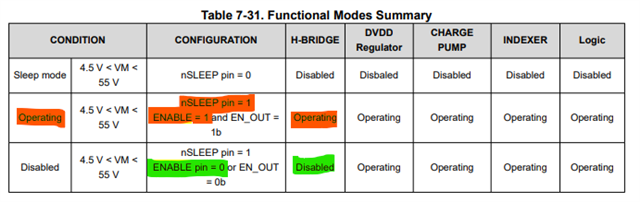

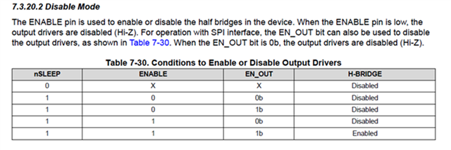

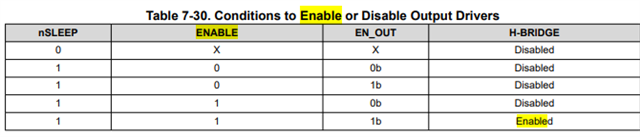

    Can the switching of the half-bridge between "Disabled" and "Enabled" be controlled by fixing "ENABLE" and "nSLEEP" to High and only setting the "EN_OUT" bit? If this is possible, what is the recommended resistor value for pulling up "ENABLE" and "nSLEEP"?
    The ENABLE pin is used to enable or disable the half bridges in the device. When the ENABLE pin is low, the output drivers are disabled (Hi-Z). For operation with SPI interface, the EN_OUT bit can also be used to disable the output drivers, as shown in Table 7-30. When the EN_OUT bit is 0b, the output drivers are disabled (Hi-Z). even with ENABLE high.
    You can pull them up to 3.3V through a 10 Kohm resistor.
