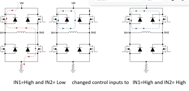

I wanted to know when i command from IN1=High and IN2=Low to IN1=In2=High....recirculation initially through Body diode of FET and after dead time it does through the OUT2 HS FET right??
Yes, that's correct. During deadtime the output goes Hi-Z and recirculate through diode then high-side slow decay will continue to recirculate with both FETs ON.
Current recirculation and Decay Modes
