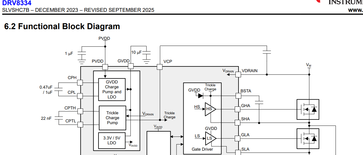

Is there any limitation to the size of the cap used for Cbst on the DRV8334? Any concerns with a cap up to 2.2uF (or larger) in value?
I see a recommended value of 1uF to 1.5uF in the datasheet.

Hi Keith,
This is really dependent on what the customer might be willing to deal with. Using a Cbst capacitor larger than what the datasheet recommend might be more demanding on GVDD to recharge the caps, especially at startup. This is especially relevant if all 3 low side MOSFETs are on, which will result in all 3 bootstrap capacitors recharging at the same time. This may cause a dip in the GVDD voltage in the attempt to charge up the Cbst capacitors, which may lead to a GVDD undervoltage fault. I think they'd be able to increase the GVDD cap if they're seeing that 2.2uF Cbst is too demanding but a large GVDD cap would also mean a slower initial power up for the device.
Have they calculated their Cbst value using this formula? is that where the 2.2uF value is coming from?
