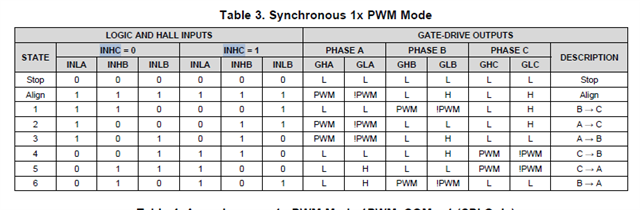

I am trying to understand how can I achieve forward and reversed direction of motor using this truth table as in refer. manual INHC will decide the motor direction which can be 0 or 1.
I have shared screenshot of truth table .
you can explain me with any example for forward and reversed
    The direction will be clockwise or counterclockwise based on the 0 or 1 setting of INHC. You leave this pin 0 or 1 depending on the desired direction.
    Can you explain what you mean by an example?
    You can see the phase transitions according to each input in the table.
