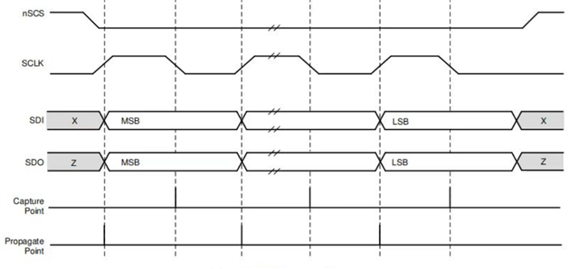

Hi Teams,
There is an issue in the datasheet where the description does not match the chart. The SPI is written as pattern 0 in the description, but pattern 1 is drawn in the chart.

Hi Vayne,
The drawing of the SPI transaction pattern is correct. There's a typo in CPHA which should be 1. This will be fixed in the next revision of the datasheet. Thank you for pointing this.
