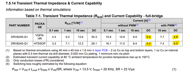

I'm using a DRV8245 in an application with a brushed DC motor. This motor operates at 13.7 volts, with a nominal current of 10 amps. I wanted to know if the chosen driver is suitable for this motor.

    I assume this means continuous current requirement for this motor would be 10 A. Brushed DC (BDC) motors have startup inrush current which would be several times the nominal current. Based on this I'd think the startup inrush requirements may be orders of magnitude higher than 10 A. For such BDC motor DRV8245-Q1 may not be suitable. See below from its datasheet. The continuous currents that can be sustained without a thermal shutdown is under the 'DC' columns.
    A more suitable option for such high continuous nominal current requirements would be a TI Smart Gate driver from our portfolio with external MOSFETs for the H-bridge. The DRV8706-Q1 has integrated current sense in-line amplifier to sense current from a in-line current sense resistor in series with the motor to read motor current from and to the bridge outputs.

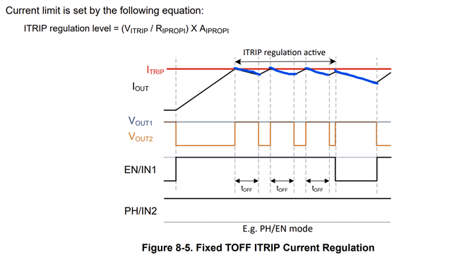

    Current sensing in the DRV8245-Q1 measures current via the high side (HS) FETs only. This would include both the driving current and the recirculation current - current from the motor while the PWM drive is off. See below. I marked the recirculation current in blue - the downward slope of the current during internal current regulation PWM off which is also output on IPROPI. This also applies to the current circulation during PWM off while INx is driven by a PWM input.

  • Thanks for the reply. My problem is the following: Motor stopped, PWM command 50% and CW direction.
    The driver applies voltage to the motor, which, being stopped, tends to draw a lot of current.
    The Itrip mechanism intervenes, the current is limited to 10 Amp, the motor starts and reaches speed.
    So far so good. Now I have to reduce the motor speed to zero.
    If I reduce the PWM to 25%, due to a large moment of inertia of the motor, which becomes a generator,
    the current reverses sign (now it flows from the motor to the driver),the Vcc from my 12V power supply increase,
    and it seems not to be measurable by Iprop. In fact, in this case the Itrip does not activate.
    If I switch from 50% PWM to 0 PWM, the current from motor to driver would invert with very high values,
    and the motor would stop very quickly.
    To avoid these problems, a current regulation is usually performed, but it is necessary
    to be able to measure the current both from the driver to the motor and vice versa.
    It seems to me that via Iprop, it is not possible to read the current from the motor to the driver.

    How long is this motor expected to be run for? At 10A of nominal current this is likely not the best device for this application unless the motor is being run for <1 second. I do agree with Murugavel that moving to one of our external FET devices like the DRV8706-Q1 would be best for this application.
