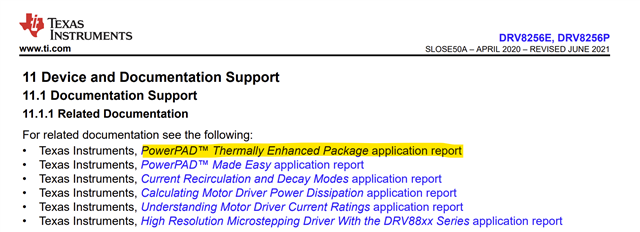

I would also like more details about the RθJA value provided in the datasheet. Was this derived from a device in free air, or from testing on a specific PCB? If the latter, could you describe the properties of that PCB?

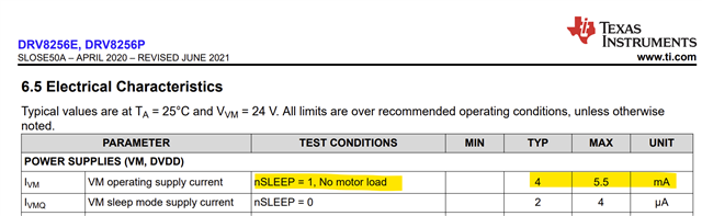

Additionally, do the listed IVM (and therefore PQ, quiescent supply current dissipation) values include the heat generated by the DVDD regulator circuit?

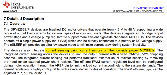

My application requires a simple and inexpensive circuit to control up to 4.2 A at 48 VDC, with current limiting based on both high- and low-side current sensing. If you have alternative device or circuit recommendations for this requirement, I would be very interested.
    If the 4.2 A is continuous current requirement, using 300 mΩ HS+LS FET @ 125 °C the power dissipation would be at least 4.2 x 4.2 x 0.3 = 5.3 W. This is outside the capability of this IC available packages thermal specification. The device will definitely experience a thermal shutdown. The integrated current regulation (current limiting) is based on only the internal low-side current sensing. This device does not have current sensing on high-side. None of the drivers with integrated power MOSFETs have both high-side and low-side current sensing because it is not necessary. In this device the internal current mirror senses the low-side recirculation current as well as the drive current flow in either direction of the H-bridge conduction.
    If your drive requirement is 4.2 A at 48 V DC you may want to consider the DRV8262 DDW package and use it in a Single H-bridge configuration.
    The cited documentation in the DRV8256 datasheet provides you this information, https://www.ti.com/lit/an/slma002h/slma002h.pdf. See section A.4 Texas Instruments Example Jedec Board Design for PowerPADTm Packages
    The DVDD regulator is active while nSLEEP = 1. IVM specification with nSLEEP = 1 includes the DVDD regulator IQ. See section 8.2.2.1.1 Power Dissipation and Thermal Calculation in the datasheet. This shows the PQ calculation. Thank you.
