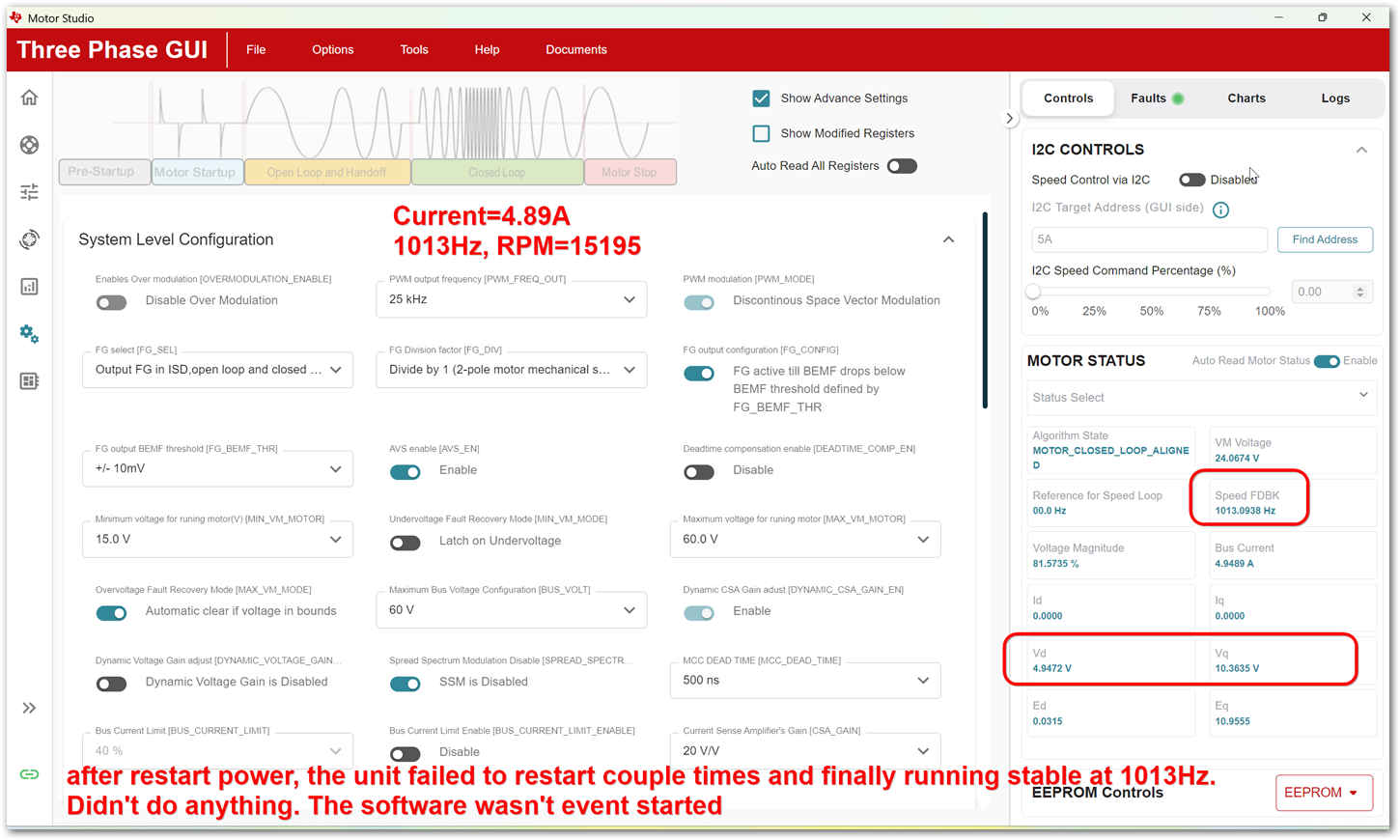

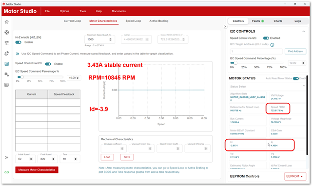

I am testing the motor drive evm board. With the help of Dhinesh, I am able to make it run:  RE: MCF8329A: Not able to complete MPET testing, not be able to start the motor using knob
The motor runs pretty well, but there are couple issues.

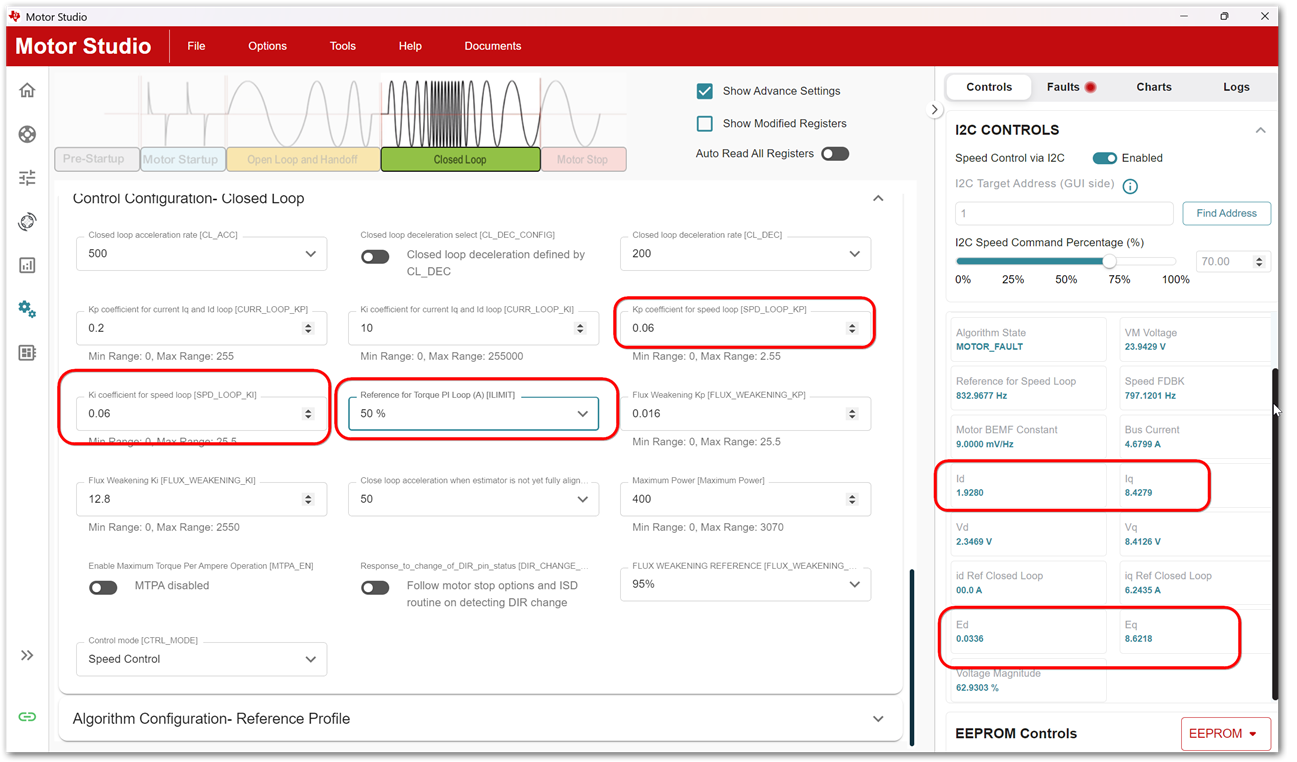

1) the current is very higher than expected. I have another motor driver testing the same motor. The current is at least 20% lower.
the Id is high. Sometime it is positive, sometime negative. Maybe the angle is not correctly set(according to chatgpt), but didn't find a way to adjust.
2) the nmos is very hot. I only use up to 4A to drive the motor. On another motor driver, the nmos is very cool at 4A current.
Certainly we can't simply compare this because nmos is different, but the big nmos shouldn't be this hot at 4A. If leave there for 1min, you finger can't touch it.
There must be a big room to improve.
This is what i did so far.
I measured the motor inductance and resistor with LCR meter, so the value shall be close enough.
Then i use the motor studio to run Ke measurement at 300Hz (it failed at 1000Hz, but it works at 300Hz as the max).
Then i switch to I2C speed control, I can run the motor at 11000rpm. The current from power supply is about 3.43A, The bus current shown in the figure is only 1.6A. Don't understand the exact meaning.
Id is very high.
I tune the BEMF  value from 8-10 (measured by MPET is 9), there is no change of the total current, so BEMF value is not the issue.
Please help to instruct how to optimize

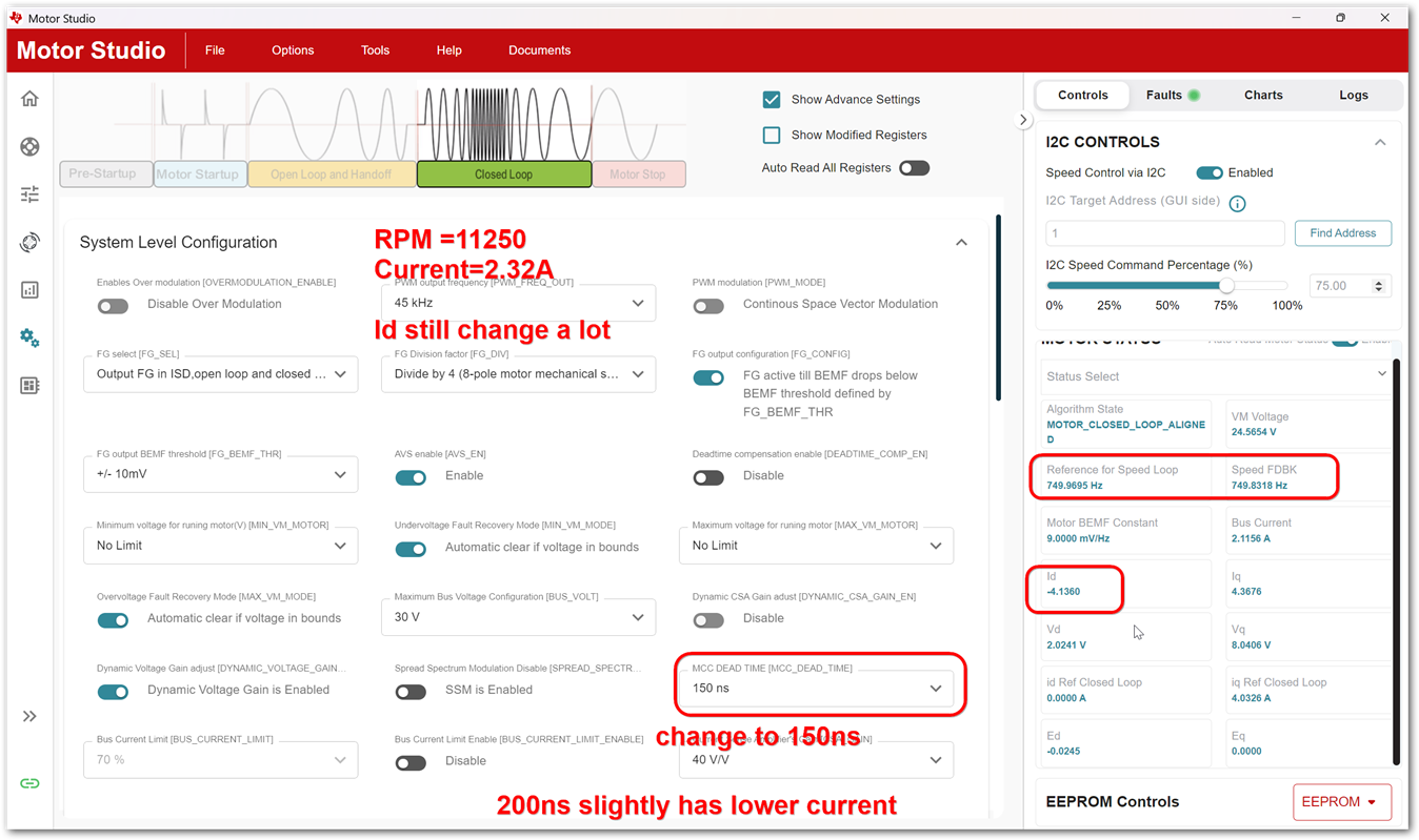

    I see deadtime configured in shared tuning file is very low (50ns), Please change it 350ns.
    We need to use motor phase resistance and inductance values for CLOSED_LOOP2->MOTOR_RES and CLOSED_LOOP2->MOTOR_IND register settings, not the one measured across two phases. Please confirm.
    Dhinesh
  • Quick reply. For the inductance and resistance, i use the measured value /2 as the value needed.
    I will test the deadtime tuning and let you know
    thanks

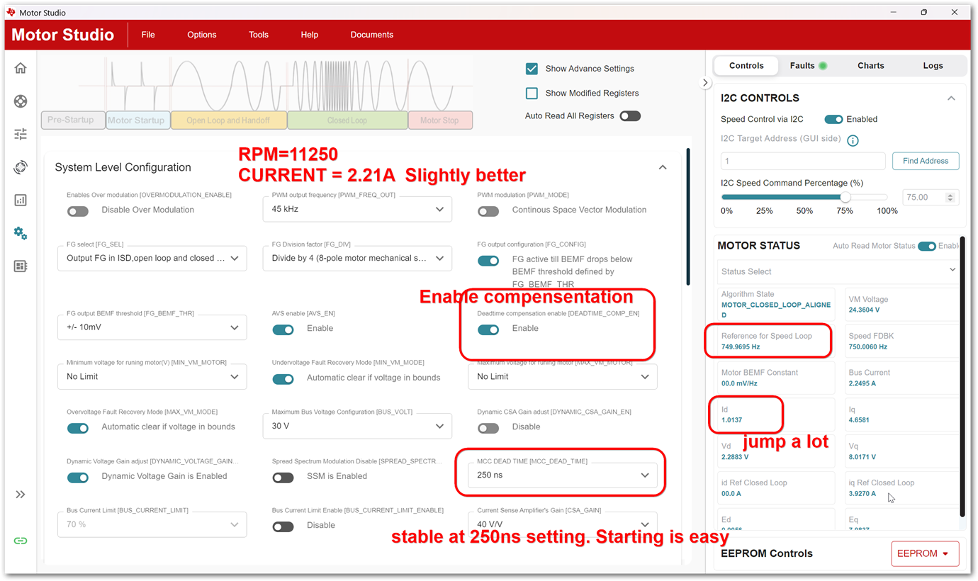

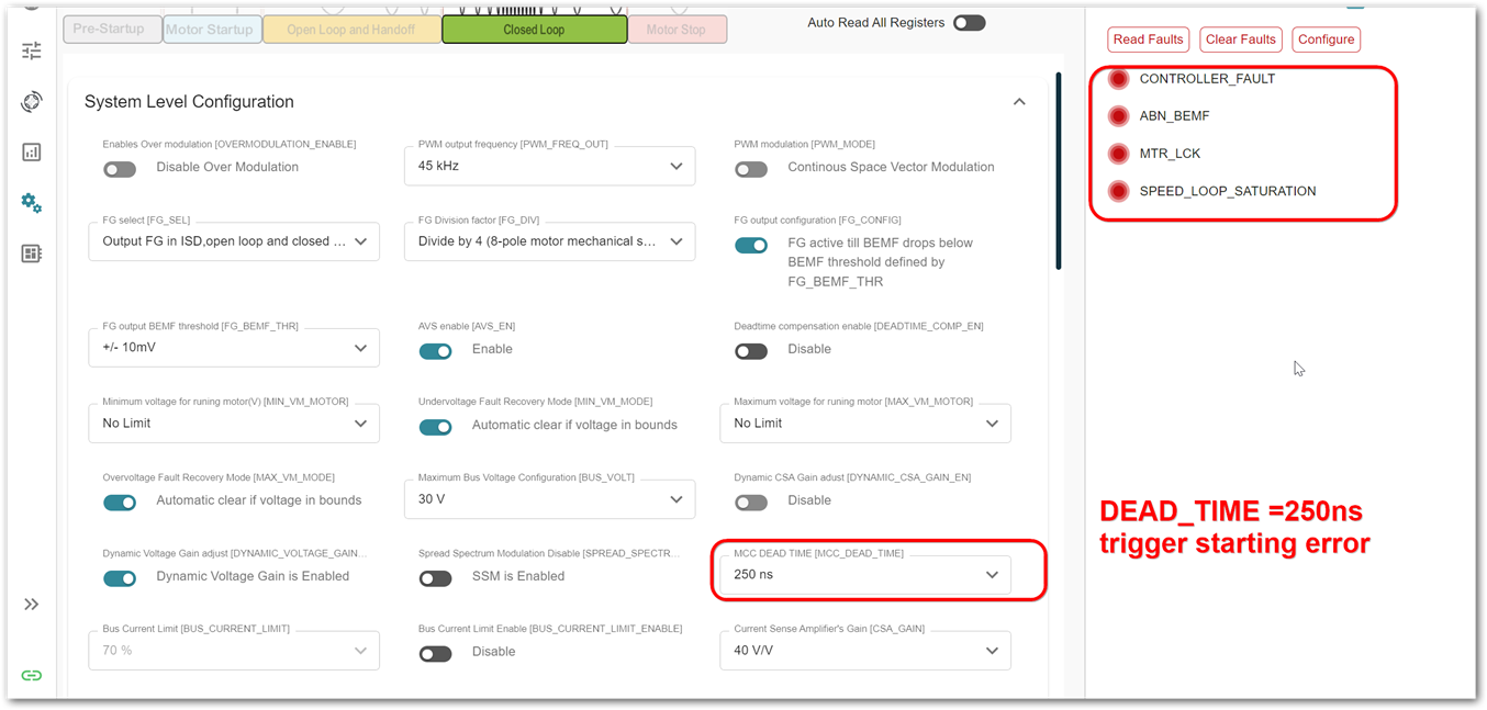

  • I tuned some time of deadtime
    200ns is the best. 150ns setting has slightly larger current.
    250ns triggers starting error, which may be fixed by other setting.
    At 200ns setting, the current is much much lower than before. dropping from 3.65A-> 2.23A, this is significant improvement.
    After turn on deadtime compensation enable , it can run at 250ns-300ns, current drops very slightly.  like from 2.23A to 2.20A (1%).
    My current issue is the Id fluctuates a lots. Suggestion on that?
    After enable the compensation, it is easy to start. 250ns slightly has lower current (very minor)
    register3-250ns.csv

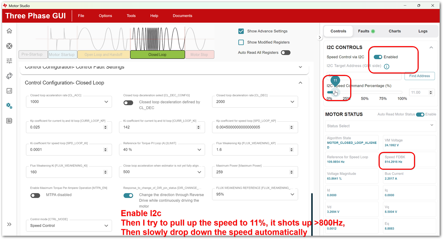

    can you try using PWM frequency (CLOSED_LOOP1->PWM_FREQ_OUT) as 20Khz?
    Also, please check whether you are able to reach maximum speed by running the motor in current control (PERI_CONFIG1->CTRL_MODE= current control).
    Dhinesh

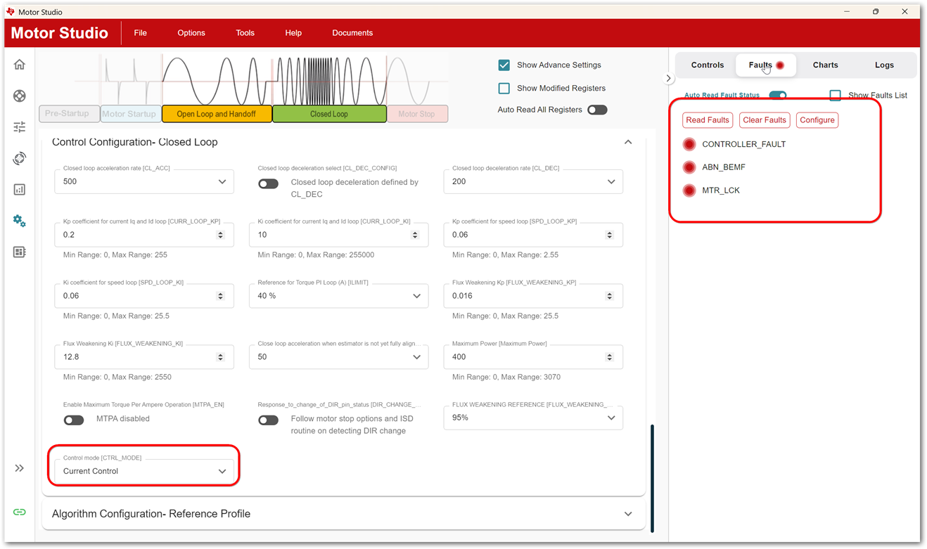

  • I tested with 30kHz, it looks worse. it is able to push to 800Hz, not above
    For current control, i am not be able to tune a good status, very difficult to start motor, and not stable
    it looks current loop has issue?
  • Hi
    Dhinesh is OOO today, until he returns let me take this question.
    I am starting with context from recent post about current control loop not working.
    I see current KP, KI is programmed with value 0.2 and 10, how did we get this number?
    I recommend write 0 to these fields and allow device to calculate and use and then optimize it if needed.
    Also, closed loop acceleration is 500, check by reducing.
    Also, try to use PWM frequency 25kHz/20kHz.

  • I redo the whole process. Please check the history.
    register-2 after auto tune.csv
    auto tune is complete. I saved to eeprom, and save the register as file: register-2 after auto tune.csv (json too)
    I double check the parameters . the parameter has been reset to some values by auto tune automatically.
    Then I power off everything. turn off the software too.
    Turn on power again.
    After reboot the system, it automatically try to turn on the motor. Failed couple times and starts finally.
    Stable at 1013Hz.
    Then I enable the I2C. I pull the speed to 11%. The speed shots up to >800 in a second, then slow down, it doesn't make sense at all.
    I can't control the starting process.
    There must be something wrong with the software.
    Please try to reproduce
    We debugged the previous issue and found that the speed loop Kp and Ki values were set to zero in the JSON file you shared. Since these values are zero, MPET starts running when you give a speed command.
    In the last tuning file, the speed loop constants were captured, but they appear to be incorrect (Kp = 0.0045, Ki = 0.0001). Could you please try running the motor in current control mode to confirm that all other parameters are working fine? Please change PERI_CONFIG->CTRL_MODE to current control mode

  • Following your instruction, i switch to current control mode. Under current control mode, I am able to tune the speed from lower to up to 1000Hz.
    If speed is too low like <20%, it is difficult to start or stable. But it is stable above that.

    For your convenience, i attached the json and csv data of the register after switch to current control mode.
    Here is what i found:
    1) either with current control mode or speed control mode. the system try to start the motor (without software), but just spin and stop, again and again, not be able to start. After the software connected, i can control the motor to start from low speed like 20%(not very low). Why?
    How can i achieve leave the motor not spin up at power on
    2) At current control mode, I can start from roughly 20% to spin the motor, above that it is stable
    3)speed control mode. The motor spin at a very high speed to start and then slow down
    3)The motor parameters like poles number seems totally has no use. After auto tune it is set to 1pairs, The actually value is 4 pairs.
    4)by default it set the current sense gain to 20v/v, I only need up to 10A(actually only need 6A). software automatically set to 20v/v. Should I switch to 40V/V for better accuracy. Can GUI optimize that too.
    Overall, the auto tune feature is great even with some bugs.
    How do I further optimize these number to be stable and easier control
    After tune, the Id and Iq seems not showing up anymore, always to be 0.
    How do i evaluate the efficiency ?
    Thank you
    I have modified some of the start-up parameters for better motor startup. I am attaching the modified tuning file.
    1. In the shared JSON file, the control mode was configured as PWM duty control mode. With the speed pin being high (100%), the motor will immediately start after power-on.
    2. Please use the attached tuning file.
    3. The speed loop Ki is very low. Try increasing it and check the speed overshoot.
    4. There is no parameter for the motor's number of pole pairs; FG_DIV is the configuration for the FG signal division factor.
    5. Yes, the CSA gain can be increased to reduce the base current. Please note that the BASE_CURRENT parameter needs to be updated along with the CSA gain change. Thanks for highlighting the Iq and Id display issue. I will update you after debugging the issue
    Dhinesh

    1. PIN_CONFIG->SPEED_MODE is the register setting to change the control mode from PWM duty to I2C mode
    4. FG_DIV number is only used for applying division factor to the FG signal. It doesn't affect the motor running.

    Dhinesh
  • I tried the register value you sent. it is very difficult to startup. looks stuck at open loop. it kept tried again.
    Based on the register I mentioned earlier, and tune the Kp Ki as you suggested, it looks it overshot much less, but still overshot.
    It is able to start and stable at lower speed to high speed(up to 1000Hz).
    The Id and Iq still didn't shows the value.
    My next step will be fine tuning the parameters. it is close to what i need.
    1) starting time slightly slow. it takes about 2seconds to start
    2)startup speed overshot
    3)fine tune to get better efficiency. The current consumption is still slightly higher than another chip from toshiba.
    The json file is attached.
    By the way, if i plan to use this one to future development of water pump application. How fast does the chip can response to signal like pulse width or analog signal or i2c command? In one of the application, there is needs that shutting down the pump right after detect an external alert signal. That means the driver needs to shutdown immediately (with 10ms, at least response time is about 10ms or less to response) when signal is received. Once the signal received, the motor should go to power off mode, or brake mode.
    Can this be achievable?

    Reduce the speed loop Kp to minimize the speed overshoot. I see from the shared JSON that CL_ACC is configured as 1000Hz/s, reducing CL_ACC also helps to minimizing the speed overshoot and improve the startup performance.
    we will look into the id and Iq display issue. it can be a GUI update issue. could you please directly read these variable data from the Regmap->Algorithm Variables.
    1. do you need align time of 4s? you can reduce this time or switch to IPD startup mode for faster startup. Also, you can adjust the BRAKE_TIME to bring down the startup time.
    2. Adjust the speed loop Kp and CL_ACC to minimize the speed overshoot
    3. can you try reducing the PWM switching frequency (PWM_FREQ_OUT) from 25Khz to 20Khz? we get better DC bus utilization at 20Khz
    Device will respond immediately to the stop command. Please refer the datasheet chapter "Table 7-6. Conditions to Enter or Exit Sleep Modes" for more details.
