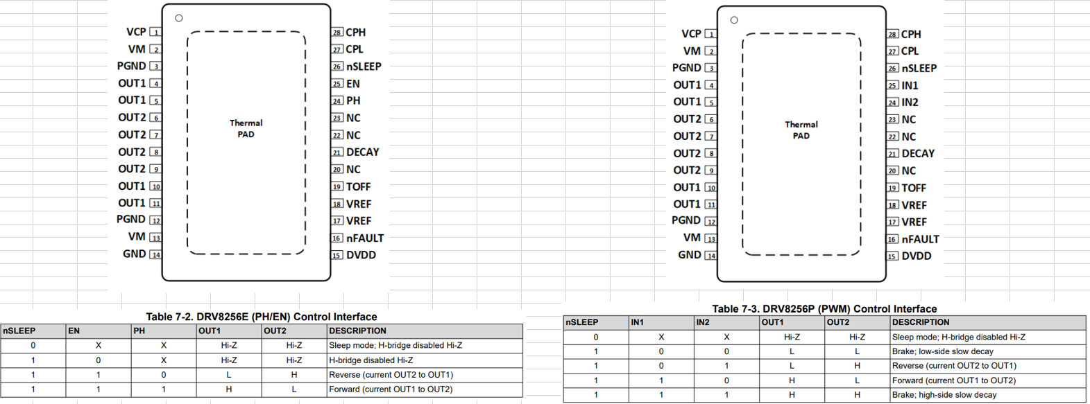

Hi team,
I have questions regarding DRV8256 as follows:
1. For PWM control, is it mandatory to use IN1/IN2 pins instead of EN/PH pins?
 Would it not work properly if PWM is applied to the EN pin and direction is controlled by the PH pin?
2. If this is not supported, is there any plan in the roadmap to release devices that allow PWM control with EN/PH pins?
3. If it does work, when driving with EN/PH control, we believe the behavior may differ depending on the rotation direction — i.e., PWM drive may insert brake in one direction and open in the other.
Do we have any plan to release devices where the drive behavior is consistent regardless of rotation direction when using EN/PH control?
