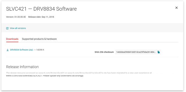

  • HI Tseng,
    Thank you for your question.
    The nSleep pin is utilized to place the driver in sleep mode, where a logic high enables the device and a logic low initiates low-power sleep mode, resetting all internal logic. To bypass sleep mode, the nSleep pin can be pulled up to VM through a 47kΩ resistor, and the output can be enabled using the nENB pin. Following power-up, the device is ready to control the output by applying logic low to the nENBL pin, with the home state defaulting to 45°. This state is entered after power-up, undervoltage lockout exit, or sleep mode exit. By applying a step pulse, the motor can be stepped forward.
    For your reference, a firmware written for the DRV8834EVm evaluation module using the MSP430 microcontroller is available below.
    DRV8834EVM Evaluation board | TI.com
    Mojtaba
