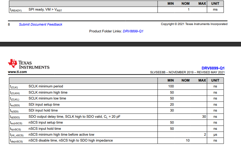

    Thank you for your question.
    To clarify, the DRV8899 device supports the SPI interface, but it does not have I2C registers. If the customer is seeking information on the SPI timing requirements or wants to control the STEP pulses through the SPI interface, please refer to section 6.6, "SPI Timing Requirements". Could you please provide more context or specify the exact concern of the customer so we can better assist them?

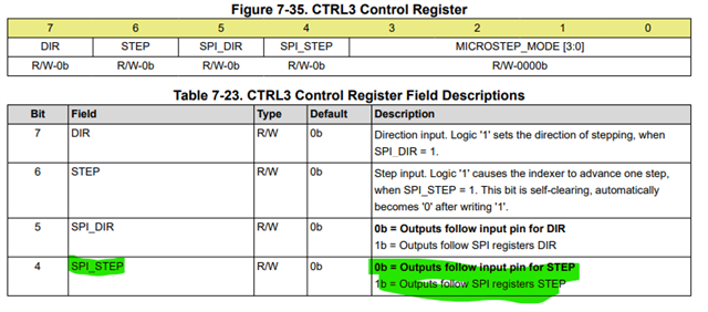

  • Hi Youhei,
    Thank you for your information.
    My customer have concern for interference about STEP input and SPI register read/write. I think these STEP and SPI R/W works separately, so there is no interference, no concern
    There is no interference between SPI and step. Depending on the SPI-STEP bit in CTRL3 register the customer can control the motor with input pin for step or over the SPI communication.
    > Can you check their query please? Is there any recommended SPI read/write timing during motor is driving(STEP inputing)?
    Please refer to section 6.6, "SPI Timing Requirements".
    Mojtaba
