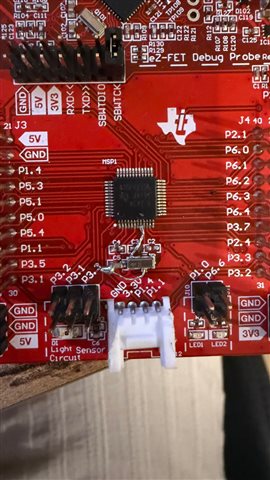

    Upon clicking the "Find Address" button in the GUI, MSP430FR2355 controller has to send out burst of I2C packets to MCT8329 to find the address. if you are sure that there are no I2C packets on the I2C bus then it can be a fault on the MSP430 controller. could you please check and confirm this?
    I don't find the 4Mhz oscillator connected to the MSP430 clock input? is this component missing on you board?
    Dhinesh
    Yes 4MHz is missing, we decided internal oscillator, our board does not includes 4Mhz external oscillator because we noticed that in the datasheet that there was no need for an external oscillator, so we did not add it, but Launchpad has an external oscillator(not 4MHz, datasheet showing 32.768kHz), and even when we tested it on Launchpad, the result did not change.
    is MCT8329 needs 4 MHz osciliator to I2C connection?
    Thank you,
    Volkan
  • Hi Volkan,
    MSP430 program is configured to use 4MHz external clock. so, we need to have external clock source connected to it.
    MSP430FR launchpad comes with a 32.738kHz crystal which is not configured in the GUI communication program. Unfortunately, this option also will not work.

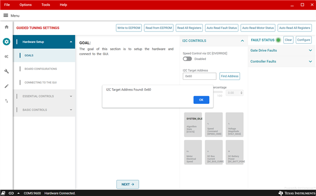

  • Hi Dhinesh,
    Thank you for your information, I2C is working now. I've replaced the 32.738kHz crystal + 2x 12pF caps with 4000MHz AS-4.000-16(16pF) + 2x 33pF caps. At least I2C address finder button is working and I can control motor speed via I2C sometimes but upon clicking the "read all register" button, the GUI getting 5-10 register usually, sometimes +10 registers and sometimes 1 reg, however it could not read all register and after that MSP connection is lost everytime.
    i2c found
    I2C Address found.
    Thank you,
    Volkan

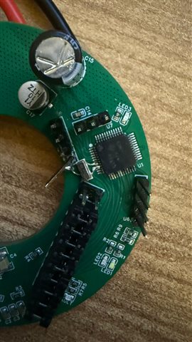

  • Hi Dhinesh,
    I've added logic analyzer capture files in zip, please check it.
    SDA and SCL remain high even when the MSP430 is disconnected
    By the way we replaced first crystal with CSTCR4M00G55B-R0 4MHz (same with MCT8329EVM resanator) but we could not detect any change.

  • Hi Volkan,
    Thanks for the update!
    Hope you connected the 4Mhz resonator with the shortest wire, otherwise it can affect the clock performance.
    once you receive the MCT8329EVM, please try connecting EVM MSP430 I2C signals to your custom board for GUI communication.
    Dhinesh
  • Hi Dhinesh,
    Thank you for your reply.
    We tried to communication by both board.
    Launchpad's wire 3-4mm
    Custom board's wire 2-3mm
    It looks near the EVM's tracks.
