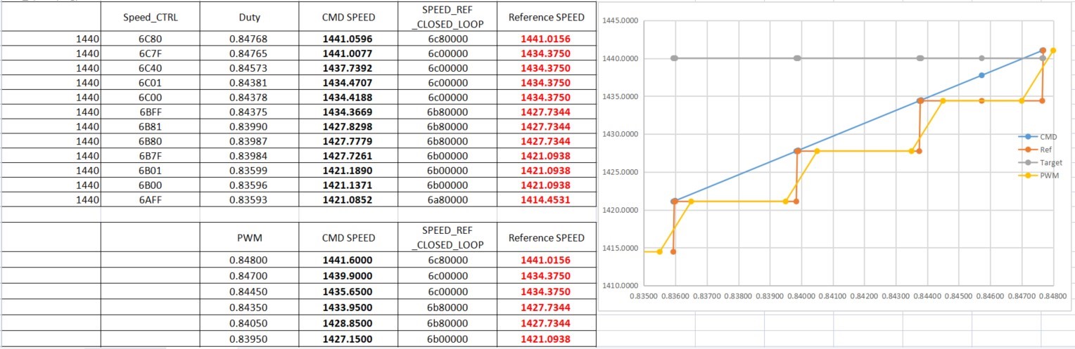

My customer is using the MCF8316C to run the motor PLL spin at 14,400 RPM to control a BLDC motor, and we have concerns about speed command resolution.
When validating speed command resolution using the GUI I2C interface, we found that the actual usable speed command is only 8-bit. Additionally, the PWM-based speed command from the MCU (10 kHz) also confirms that the speed command resolution is 8-bit. Based on previous experiments, an 8-bit speed command resolution cannot achieve stable motor index PLL control at 14,400 RPM.
