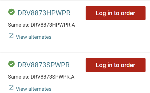

    There are two orderable variants for this product. See below. The DRV8873H is fully GPIO based for configuration, control and fault diagnostics. The DRV8873S has SPI for configuration, control and fault diagnostics using registers as well as GPIO control options for inputs and fault reporting via nFAULT pin.
    Current sense IPROPI1,2 analog output is similar in both H and S variants. More details in the datasheet.
