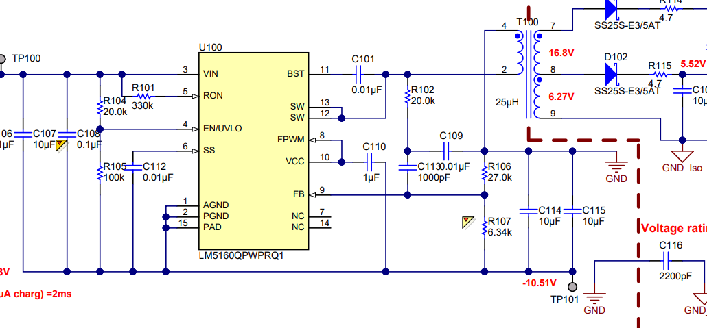

Schematic for Power Supply of TIDA-01418 shows pin 4 of FlyBack transformer is grounded while Pins 1, 2 and 15 are floating.
Datasheet for LM5160 IC shows exactly the oposite.
In my opinion, the GND connection on pin 4 of the transformer should be where TP101 is.
(Schematic view).
Please confirm.
If this is true, is there an updated version for the schematic and the Gerbers ?
