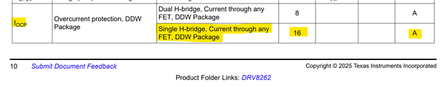

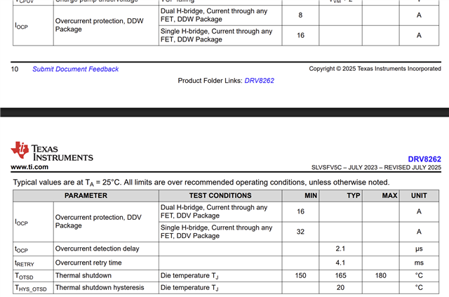

    The second is the over current protection OCP which helps with output short circuit protection. The threshold for OCP is given in the IOCP specification - see below. The IOCP specification is hard coded and cannot be changed.
    The OCP is independent of the current limiting feature and does not depend on RIPROPI. See below. OCP has its own sensing on each of the output FETs both high side and low side.

    In your current schematic, VREF = 3.3 V, RIPROPI = 3.3 kΩ. This calculates to Itrip = 4.72 A. Because you are using Single H-Bridge mode the IOCP is 16 A , it is 8 A for dual H-Bridge mode.

    The OCP overcurrent architecture is different. For each NMOS it is 8 A. When connected in parallel for Single-H the OCP limit at the OUTx pins double to 16 A.
