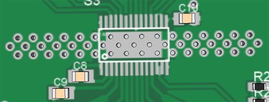

Dear Sirs,
we designed a circuit with your DRV8825 chip to drive some stepper motors. At the beginning it looked that everything was fine, but after stress testing we "burnt" two DRV8825 chips. In both cases the DRV8825 controllers were working for more than 10 minutes and after powering down and enabling the power the controllers were in short-circuit. In both cases micro-stepping (1/16) was enabled, no fault condition was ever present, the controllers were also additionally cooled by a fan and until powering down everything was working flawlessly. The VMx voltage in our design is 24V, the digital side is on 5V and the Vref pin voltage is between 3.5V - 1.7V.
Now our question is what can be the cause of this problem? The DRV8825 controller has an internal shutdown protection for over-current, short circuit, under-voltage and over-temperature this is why we are very surprised that something like this happened twice.
Any suggestions and replies are very much appreciated.
