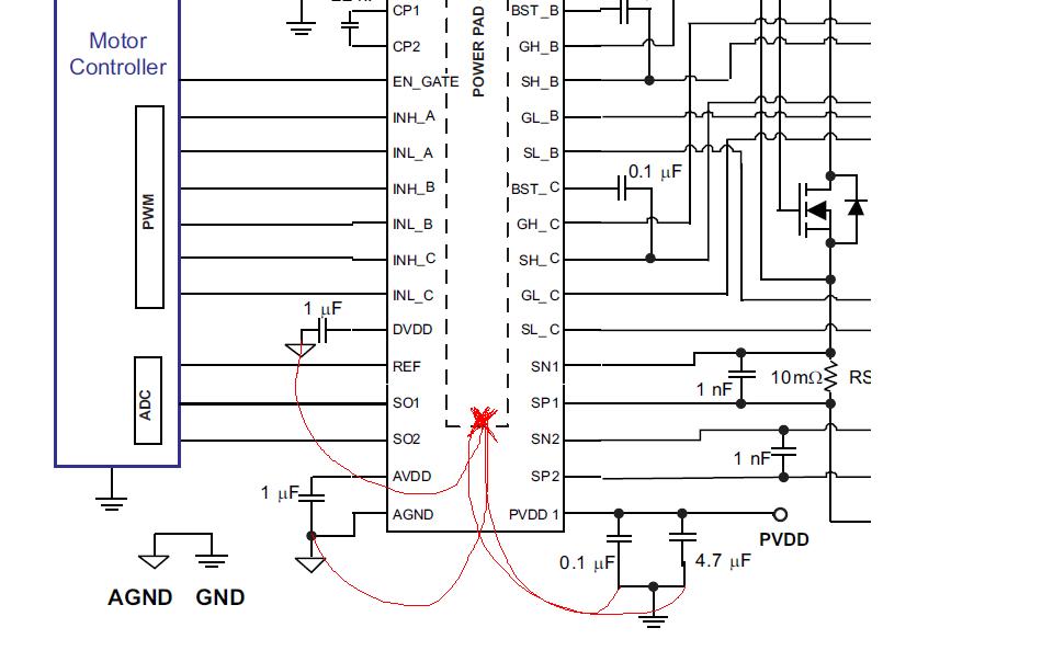

Dear All,
 I am debugging using customer board(TMS320F28035 + DRV8302: DC bus voltage: Max 32V, Phase Current: Max 20A, RPM: Max 3000RPM, PWM= 15kHz, Servo Motor).
Unfortunately we found "FAULT" signal as soon as we operated.
(The signal pattern of "FAULT" pin is " High-Low-High-Low-High-Low-...". As it were, high-low pattern repeated continuously.)

  • Which SW are you using (does the InstaSPIN-BLDC GUI connect and show a green button?), or is the fault on immediately?
    How is the solder joint on the CAP between the PWR and GND connectors?

  • Joseph,
    My best guess with the information provided is to check the GND connections on the decoupling for AVDD (pin 28), DVDD (23), and PVDD1 (29).  The GND connections for these decoupling capacitors need to be as close as possible to the PowerPAD GND connection (the exposed pad on the bottom of the IC).
    Also note, the PowerPAD must be soldered to the PCB and have a solid connection to board GND.  This is the only GND connection for the IC and must be made for proper functionality.
    I have attached a visual of how this should be done.  The traces need to be as short as possible.
