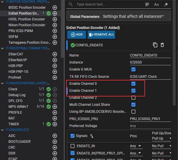

Using endat diagnostic multi channle load share,  I noticed the following behaviour
Once I configured the syscofing to use channel 0 , 1. It seems the driver layer expects to both channels are connected to enoders.
I am getting the follwing error
EnDat firmware  : 1.0.4 (release)
channels 0 1  selected
ERROR: EnDat initialization failed -
        unable to detect encoder in channel
exit endat_main due to failed firmware initialization
when only 1 channels in connected to actual encoder.
Is there any way I can configure/modify the driver layer to confrom to my use case below
1- I have 2 encoder channels , CH 0 and CH1
2- Not all channels have to be connectected to physical encoder. The encoder controller should be able to detect which channel(s) are connected
3- I should be able to proceed based on connected encoder channel. Ie if only channel 1 is connected,  I should be able to read position on channel 1
Let me know if this is possible

  • Hi Achala
    Thank you for the suggestions , I have managed to implement the suggestion with partial success.
    Our Use case
    1- Build a system with 2 physical encoder channels
    2- The user can connect 1 or both channel or none to encoders channel
        Possible combinations
        CH0 : Connected  CH1 : Not Connected ( NC)
        CH0 : Connected  CH1 : Connected
        CH0 : NC  CH1 : Connected
        CH0 : NC  CH1 : NC
    3- The System will need to autodetect the channels  with encoder connection and continue operation based on connected encoders.
    From firmware perspective, we would to have a single firmware that is able to handle all scenarios above
    4 - I need enable above capability on Endat , BiSS and HDSL protocol
    Current status
    1- I have modified  endat_wait_initialization to become  endat_wait_initialization_partial  where the return values has been changed to the following
    0 - None connected
    1- Only CH0 Connected
    2- Only CH1 Connected
    3 - Both CH0 and CH1 are connected
    It seems the lower layer is able to handle case 1 &3 , but it is having to problem to detect encoder on CH1 when CH0 in not connected to physical encoder ( case 2)
    Let me know if you need more information.
