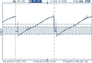

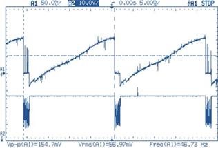

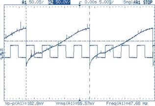

I'm relatively new to motor control. I have had an existing design that appeared to be functioning properly, that I borrowed from a previous design used in a similar application. However, I've recently had to change my motor winding impedance from 20Ω to 40Ω. I am noticing that the DRV8811, with the new motor coil, does not seem to have enough time to ramp all the way up to the current limit I’ve set before I need to step the motor to the next position, and there doesn’t seem to be any way to adjust the time rate of change of the current through the coil. I am wondering:
  1. Am I right when I say there is no way to increase the “ramp-up” speed of the current through the motor winding
  2. Is 40Ω, or 20Ω for that matter, a large, average, or small impedance for the coil. I didn’t think much on it until now, but that seems like those might be large numbers
  3. Is there perhaps another issue I’m fighting with, and don’t have enough experience to notice it yet.
 I’ve attached some waveform images below, for reference. They were taken with a fairly old HP scope and a passive 1x probe, so I might not be noticing all the details. From the images, it appears that I don’t really enter decay mode, with the exception of when I’m microstepping, and it seems like the driver is being slammed off (ie, no decay). I have also noticed, though, that the times for decay and blanking are seemingly on a different scales than my charge time, which is concerning me as well. I’ve checked the rest of the circuit, and I believe it’s set up properly (for slow decay operation). Thanks in advance to anyone with some advice for me.
CH1: Voltage across RSENSE_A
CH2: Step Input (Half-step)
CH2: Step Input (Eighth-step (microstep))
CH2: Voltage at RCA (Decay voltage)

    Also notice that current chopper topologies rely on the fact that current will not be chopped until it reaches a value. How long it takes to reach this ITrip value, however, is the system's responsibility (e.g. the voltage, the inductance and the BACK EMF). In other words, the driver has no mechanism whatsoever to push the current into the winding. All it can do is wait until the value is reached. You are correct in stating "there doesn’t seem to be any way to adjust the time rate of change of the current through the coil" as the only way in which you will be able to see this change is by modifying the input voltage, or changing the motor speed. Changing the motor inductance in real time is of course not viable.
    You also state there is no decay taking place, unless on microstepping. When on full step, only slow decay mode is employed. It is tough to see current regulation by looking at the SENSE pin, but what you should see is 0V when on slow decay and negative voltage while on fast decay. It is considerably easier to see current decay with a current probe, if you happen to have one of these available.

    Because of how long it takes for the current to reach the ITRIP value, it is just not possible to see multiple enablement/disablement cycles on the SENSE pin. In fact, if you are issuing steps, it is very possible you are issuing a step long before you reach the programmed ITRIP. When this happens, you can feel assured you will not see the typical current regulation depiction featured on the datasheet. Do note it is also possible you are not even reaching the programmed ITRIP value as the saturation current can easily be below this value. For example, if you have programmed ITRIP to be 1A and the VM is 24V, since the motor saturates with 600 mA, you will never see an ITRIP taking place. In this case, you will not see a decay event.
    When it comes to seeing the actuation of ITRIPs, there are only two things that can happen:
    1. You see the current being regulated. This happens when the combination of voltage, motor inductance/resistance and BACK EMF are such that the ITRIP value is reached before a new step command is issued. This is typical of rather slow to mid speeds, and it is more prevalent with lower motor resistances/inductances, or with higher application voltages. I have seen motors with a 0.8 ohms resistance. In this case, the current regulation is quite aggressive, even at lower voltages.
    2. You do not see current being regulated. This happens in a case like the one you are experiencing in which the inductance/resistance value is so big, it takes too long for the current to reach ITRIP. The other scenario where this is typical is if the motor is going so fast, the BACK EMF is a voltage so close to the source voltage, the inductor has almost no voltage to charge up. In this case, the current is so small it cannot reach the programmed value. This is why on those cases in which the motor is moving very fast, microstepping is impossible to achieve. At these rates, the BACK EMF distorts the sine wave until it looks like a saw tooth wave. Then the stepper starts to behave like a BLDC motor, and its current almost looks like a sine wave again. Very cool to watch under an oscilloscope if you have the chance!
    Yes, you can look at current by looking at the SENSE pin. You will get an idea of how the current looks, but if you have the current probe, it is so much easier. Just remember the decoding table I specified before. Slow Decay looks like 0V and Fast Decay looks like negative voltage. I also prefer the current probe as it is easier to see current magnitude and current polarity. Through the SENSE pin you would need to compute the current magnitude and look at the power outputs to determine polarity.
